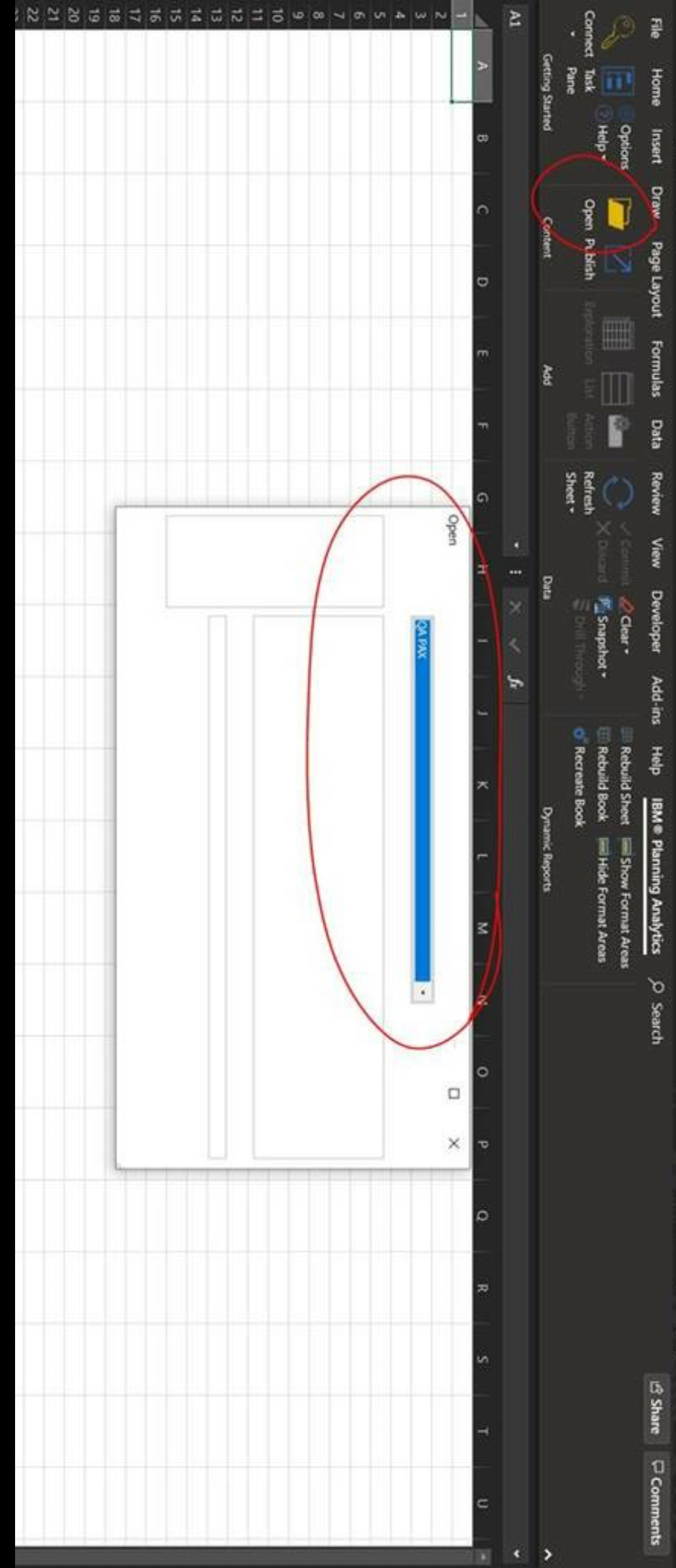

Have attached the screenshot from users machine

I see QA in the connection name. Have you confirmed the user is in the users list for the QA PAX environment? You could try having them log in through PAW in browser and see if they're able to get in. User list in PAW is different than }Clients dim on TM1 server.

Yes have checked the role of the user on QA PAW, he is having Analyst Role & also he can able to login into PAW from browser. Interesting part is user can able to view all kind of reports on PAX using qa pax connection the only issue is inside Open icon the server's list is missing
Also we have this PAX installed on Citrix servers where he can see the list under Open icon but in his local machine list is missing. I am not sure if something is wrong from his machine
