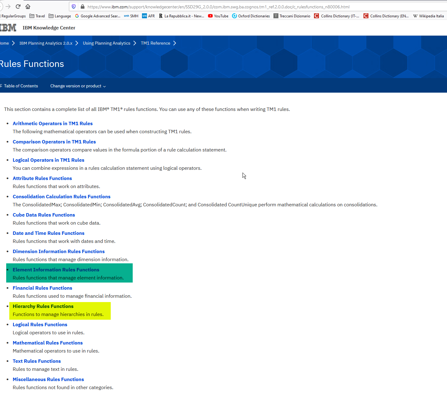

If you are looking at the help page (which, yay you because so many people don't bother), if you're in any doubt at all make sure that you go up a couple of levels to see which category the help page falls into. The one that you had a link to was in the Hierarchies category, which refers to the PA2 "Alternative Hierarchies" that I described above. Functions like ElComp on the other hand are "traditional" "hierarchy" (let us never call them that again) functions, which you will generally find under "Element Information" or "Dimension Information".

No really you don't. They have just published the documentation for the worksheet function on the page for the rules function. The function seems to be working as expected from what I can see. Although you do wonder what's the point when DFRST('dimension:hierarchy') works perfectly anyway.
Makes sense - not sense as in sensible, but the syntax looked really silly.
