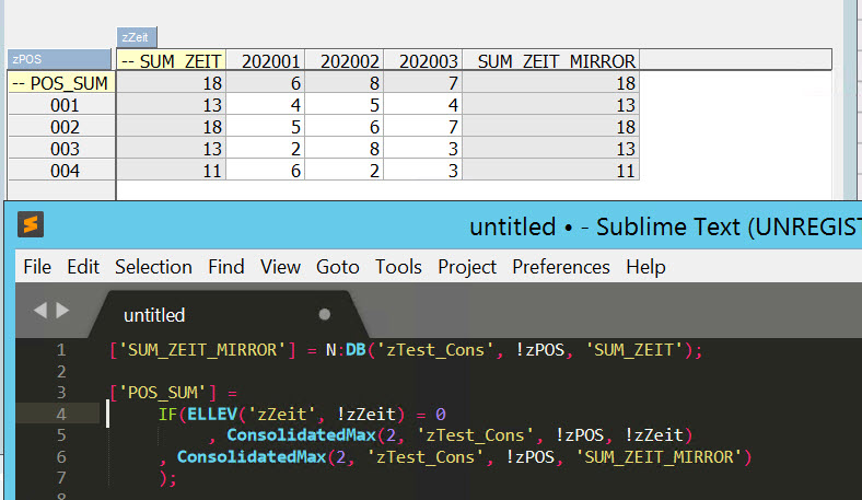

i've got a problem with using ConsolidatedMax in a Rule. Let's say my Cube is 3d with the Dimensions WS_POS, WS_Zeit and WS_Kennzahl and whenever I look at a C-Element in my WS_POS Dimension, I want to see the Max value.
My rule is like:
['WE-EB-Option'] =
IF(DTYPE( 'WS_POS', !WS_POS) @= 'C'
ConsolidatedMax(2,'WS_Planung',!WS_POS,!WS_Zeit,!WS_Kennzahl),
continue);
Now, what happened is this:
The SUM_POS is correct when I look at the N-Elements at my WS_Zeit Dimenson -> it's the max out of the POS-Elements.
And what I've expected here on my C-Element "KJ-2099" is the same. I want to see there a 68, not a 9, because it should be the max in here.
Where is my fail? Is ConsolidatedMax here the wrong funktion or do I think in the wrong direction?

I'm not familiar enough with the consolidation functions to speak confidently, but it looks like the consolidation function is doing what I would expect it to do: return the max value of N level values. Taking the max of naturally consolidated values might not be within the capabilities of these functions, but I don't know that. You can get around this assumed limitation, by creating an N level element and writing a rule to populate that value with the consolidated value you want to take the max of, "KJ-2099" in your example, "SUM_ZEIT" in mine pictured below. You would then take the ConsolidatedMax of that value in your C rule for SUM_ZEIT.

I've already tested some workarounds, but all of them are getting nasty in some ways. I guess your idea will go in the same direction. In total I have to handel 12 Dimensions with that requirement and of course there are some exceptions, where the rule should not be triggered in that way.
My hope was to find an easy way to solve it, but I guess I can dream on... :)
The problem could be solved so easily by getting the max out of the consolidated values too.

thanks for your reply. Yes, my "solution" is a mix of both, consolidatedmax & consolidate children. Definitely very ugly, but it seems to work.
It's going something like this:
& DTYPE('WS_Marke', !WS_Marke) @= 'N'
& DTYPE('WS_Warengruppe', !WS_Warengruppe) @= 'N'
& DTYPE('WS_Segment', !WS_Segment) @= 'N'
& DTYPE('WS_Zeit', !WS_Zeit) @= 'N',
consolidatedmax(2,'WS_Planung',!WS_Marke,!WS_Warengruppe,!WS_Segment,!WS_Option,!WS_Groesse,!WS_Channel,!WS_POS,!WS_Zeit,!WS_Plantyp,!WS_Version,!WS_Kennzahl,!WS_Wertfeld),
IF( DTYPE('WS_POS', !WS_POS) @= 'C'
& DTYPE('WS_Marke', !WS_Marke) @= 'C'
ConsolidateChildren('WS_Marke'),
