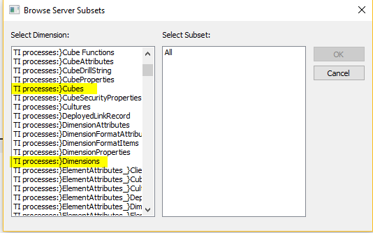

first of all thanks for posting those useful codes on your website! I'm trying to follow your steps creating a process to trace which cubes use a particular dimension, but I'm stuck where it says "navigate towards subset All on the dimension }cubes", I have a bunch of them that I'm not sure which one to pick:
Alectra-ES:}Subsets_}.Dimensions (I have this listed twice)
Alectra-ES:}Subsets_}.Cubes (I have this listed twice)
I wonder why they are listed twice?
can you please advise me?
thanks!!
Re: Which cubes use a certain dimension
That would be weird, I currently see:
Also, I found an easy trick to quickly see in which cubes a dimension is used: Go to the dimension's Subset Editor, then Tools > Filter... and the dropdown will show you the cubes containing the dimension.

then I'll use the trick you just showed me for this, thanks again!!
