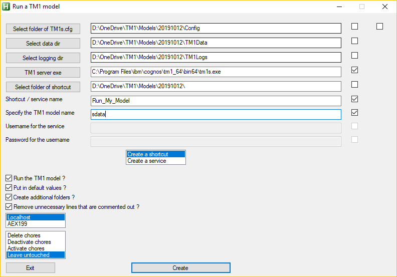

Here is a custom script of mine to set up a TM1 server quickly and run it as an application or service.
It will be useful to those who set up TM1 models rather frequently (be it new models or test TM1 models or setting up a model locally to verify), etc.
Go to Windows Explorer and start the tool. The first action of the tool is to navigate to the folder containing the tm1s.cfg file. Some knowledge of AHK is needed. I assign the shortcut Alt-F12 but you choose what you like best ;-)
The script contains a number of options, for example create a tm1s.cfg file if it does not exist, select the data directory by clicking the folder name, assigning random port numbers, create custom folders, etc.
Communication with you, the user, is done via a GUI. The rationale behind this script is saving time and effort because of typo's, repetitive actions, looking up folder names and so on, copying existing files and folders, ... after setting up a few 100s of these I got pretty tired :lol:
You only need this code and no other libraries.
All feedback is welcomed.
Wim

gui, tm1_as_app:new
gui, add, Button, vBut1 gBut x10 y+20 w150, Select folder of TM1s.cfg
gui, add, edit, vEdi1 x+20 w500 r1 gChanged_Editbox
gui, add, CheckBox, vChbx1 x+20
gui, add, Button, vBut2 gBut x10 w150, Select data dir
gui, add, edit, vEdi2 x+20 w500 r1 gChanged_Editbox
gui, add, CheckBox, vChbx2 x+20
gui, add, Button, vBut3 gBut x10 w150, Select logging dir
gui, add, edit, vEdi3 x+20 w500 r1 gChanged_Editbox
gui, add, CheckBox, vChbx3 x+20
gui, add, Button, vBut4 gBut x10 w150, TM1 server exe
gui, add, edit, vEdi4 x+20 w500 r1 gChanged_Editbox
gui, add, CheckBox, vChbx4 x+20
gui, add, Button, vBut6 gBut x10 w150, Select folder of shortcut
gui, add, edit, vEdi6 x+20 w500 r1 gChanged_Editbox
gui, add, CheckBox, vChbx6 x+20
gui, add, Text, x10 w150, Shortcut / service name
gui, add, edit, vEdi5 x+20 w500 r1 gChanged_Editbox
gui, add, CheckBox, vChbx5 x+20
gui, add, Text, x10 w150, Specify the TM1 model name
gui, add, edit, vEdi7 x+20 w500 r1 gChanged_Editbox
gui, add, CheckBox, vChbx7 x+20
gui, add, Text, x10 w150, Username for the service
gui, add, edit, vEdi8 x+20 w500 r1 gChanged_Editbox
gui, add, CheckBox, vChbx8 x+20
gui, add, Text, x10 w150, Password for the username
gui, add, edit, vEdi9 x+20 w500 r1 gChanged_Editbox Password
gui, add, CheckBox, vChbx9 x+20
Gui, add, ListBox, r2 x250 choose1 gChanged_AppOrService vAppOrService, Create a shortcut|Create a service
Gui, add, CheckBox, Checked0 vChbx_RunModel x10 y+20, Run the TM1 model ?
Gui, add, CheckBox, Checked vChbx_Put_In_Default_Values, Put in default values ?
Gui, add, CheckBox, Checked0 x10 vChbx_Create_Addit_Folders, Create additional folders ?
Gui, add, CheckBox, Checked vChbx_Remove_Unnecessary_Lines, Remove unnecessary lines that are commented out ?
Gui, add, ListBox, r2 choose1 vAdminHostChoice, Localhost|%A_computername%
Gui, add, ListBox, r4 choose4 vChoresChoice, Delete chores|Deactivate chores|Activate chores|Leave untouched
GuiControl,,Edi1, %currentpath%
GuiControl,,Edi4, %cPath_TM1s_exe%
GuiControl,,Edi8, %cWin_Username%
GuiControl, Disable, Edi8
GuiControl, Disable, Chbx8
GuiControl,,Edi9, %cWin_Password%
GuiControl, Disable, Edi9
GuiControl, Disable, Chbx9
gui, add, Button, vBut7 gBut w100, Exit
gui, add, Button, vBut8 gBut x+150 w200 Default, Create
gui, show, , Run a TM1 model
return

Re: AutoHotKey - run TM1 as a service or as an application
The above code was extended greatly by myself, not in the least by adding a GUI. If you often need to run different TM1 models, you will definitely want to use it.
You will probably want to:
  • download and install AutoHotKey
  • copy/paste the code to a text editor
  • save the file with a name that you want and extension .ahk
  • double click the file to run it
  • select a folder in File Explorer with the TM1 data directory
  • press Al-F12
  • use the gui
The advantage is that I have given you all the code in text format and you can change any line you want.
I could also compile the AHK script as an EXE file for you to download and run but then you don't have the source code and you cannot make changes at that level.
