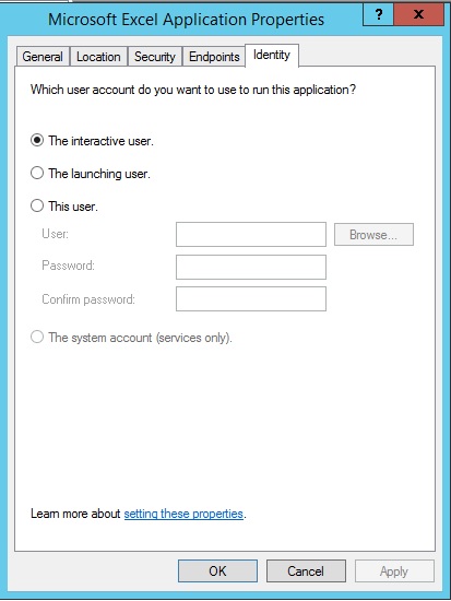

- Go to "Start" -> "Run" and enter "MMC comexp.msc /32"
- Go to the properties of Microsoft Excel Application, under Identity, change it to This User from The Launching User (which is set by default). Input the credentials of TM1 services user account

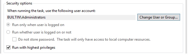

- I am not using a TI process to start anything, but just a scheduled task
- The task runs with an account that is part of the 'Administrators' group
- If I schedule the task to run at a certain point in time, so scheduled, and I am logged on: it works fine.
- If I schedule the task and I log off (and everyone else is logged off): it does not work

Can you see under what user 'excel.exe' process is running in this case? Yours or the one you set up in Scheduled tasks?
Interactive Identity setup will launch excel under your account, specifying an account should run it under that account.
Re: TM1 report bursting
If Excel identity is interactive, it's my username (wimgieli)
If Excel identity is the launching user, it's the username with which the task is created (tm1burstservice)
I now have the following:
- everyone logged off, Excel identity set as the user wimigeli and the scheduled task running under wimgieli: it runs a macro BUT !
* opening an Excel file normally (logged on again, as wimgieli) seems to produce error messages in Excel about the content of the file (I have to change the Excel identity back to the launching user to open up Excel files normally again - I wonder whether that will give adverse effects in the future in case (power) users log on to the server and open a file directly on the server
* Application.Run TM1REFRESH and similar macro's do not run while clearly the tm1p.xla is loaded (confirmed with text files). It's about twevrecalc1 and such errors
