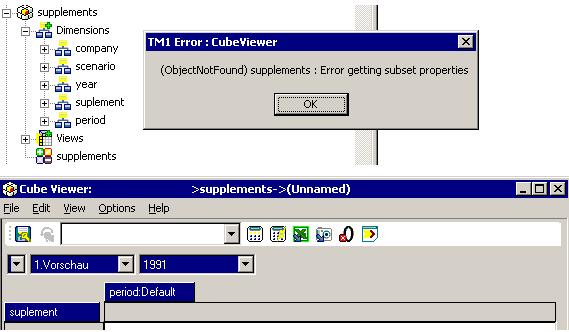

When a client double-clicks the cube to open the CubeViewer, a message box opens, reading "(ObjectNotFound) <cubename> : Error getting subset properties". You can click it away to catch a glimpse of the CubeViewer opening and closing immediately... You can find the screen-shot attached below, I censored the servername away since I don't know whether I am allowed to show it or not - better to take no risks :)
As you can see in the screen-shot, the first dimensions drop-down is empty, the first dimension is the company dimension which happens to have a perfectly fine working default subset, at least when opened in SubsetEditor.
In this case I was able to open some Views of this very cube - when I assigned the company-Default subset to title, the same error occured after recalculation. The next biggest subset, "Standard" (German for default, a remainder of old days when clients had a German TM1 version), would work perfectly fine.

Server &amp; Client 9.1 SP3, Perspectives with Excel 2003 SP2, English language in both, Client &amp; Server<br />When opening the CubeViewer by double-clicking at the cube
Server & Client 9.1 SP3, Perspectives with Excel 2003 SP2, English language in both, Client & Server

No, there is no explicit Default-View. If there was, at least I assume, deleting it would not have solved the problem - as mentioned I can take a working view (any view not having the Default-Subset of company dimension) and render the cubeviewer useless by selecting the company's Default-View (either title, rows or column will kill the thing)
The dimension is updated via xdi - forgot to mention that explicitly. The dimension was updated this way a couple of hours earlier, but right after the update it worked just fine. (this is a fact, the editor of the dimension checked the result)
