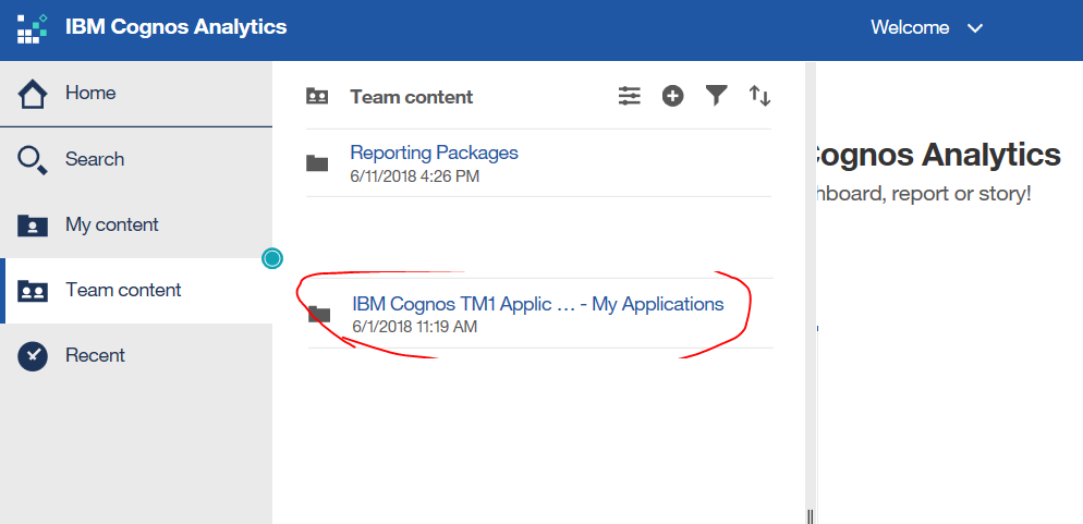

I see that many people have seen it, but have not answered. Thought it's good to add a picture for reference t oexplain.
The missing folder is 'IBM Cognos TM1 Applications - My Applications' .
Paul.
Paul.

Re: TM1 applications not available in Cognos Analytics
The "Applications" folder name is set in pmpsvc_config.xml file (<tm1 install>/webapps/pmpsvc/WEB-INF/configuration/). Is it correct here?
Is it a completely new blank server, or you have migrated from another instance? If so, from which version? Did you migrate Content Store database?
Try to create new application. Will the Apps folder be created in CA?
