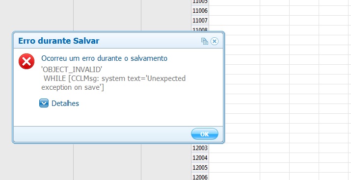

I am trying to create a new view of a cube in Performance Modeler (I would like to do this on Architect, but on the customer I can't use Architect on PRD environment because of restrictons of firewall and etc), and I can just set up few dimension on the rows, but after a while I got this error (attached).
Does anyone knows something about this?

Error on view creation
- Error.jpg (47.53 KiB) Viewed 9642 times

What was the different error message that it gave you?Jorge Rachid wrote: ↑Tue May 22, 2018 12:25 pm Hi, i've tried that but I face the same problem. The type error is different, but didnot work too.
When you tried Pauls idea to copy from your dev environment, did you only copy the vue file? If the vue relied on subsets that didnt exist in prod you would need to copy those over as well.

I'm trying to generate the same view on tm1web to show the error.
I only copied the vue file. I've checked the view on dev and many of dimension of the cube aren't set with subsets. There is any problem with this?
If it is, it might not working because of that.
As soon as I get the error I'll post here.
