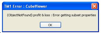

Oh, I forgot my second problem I think might be similar, although it occurred at another server.
Server & Client 9.1 SP3, Perspectives with Excel 2003 SP2, language in sync
Have a look at the attached error-message.
This occurred when a user (in admin group) opened a view an tried to select an other element in a title dimension. The subset should be dynamic, but changing it to an other one didn't help. Restart solved the problem.
Since both servers are rather similar (security-distribution in process & rules) the errors could somehow be related...
Unable to open View / pick element from subset in CubeViewer

- errormsg.JPG (11.05 KiB) Viewed 7649 times

Re: Unable to open View / pick element from subset in CubeViewer
You may have a corrupted or missing subset somewhere.
That was my first thought too - but a restart should not auto-repair subsets, eh? And if TM1 manged to have corrupt subsets in memory, everything is lost anyways, so that solution is not an option
I remember getting that error if you got timed out. Or it can happen, like most times with me, is our wireless connection fails and you lose your IP. Subsequently you lose your connection to the Tm1 server as well.
Thanks, that could come in handy for problems in the future, in this case it won't apply tough.
The first described problem occurred on the machine (via mstsc) itself, the second one was limited to that very subset, some other could still be accessed and altered.
A college of mine deleted the views blb-files prior to start of the server. Since my plain restart resolved the problem aswell, I don't suspect the blb-files to be corrupt or bad.
