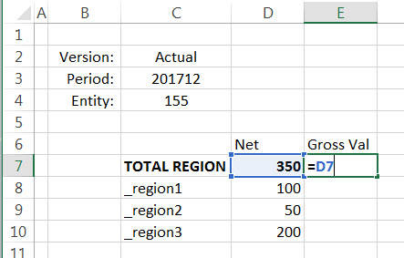

Re: Need help with Rule to write to Consolidated Level
Did i get your sample cube mocked up right in the attached picture where you want DB('Sample Cube', 'Actual', '201712', '155', 'TOTAL REGION', 'Gross Value') to equal DB('Sample Cube', 'Actual', '201712', '155', 'TOTAL REGION', 'Net')? If so, the right side of your consolidated rule is simply a DB ref to where the Net value is.
- AshleighW_Cons_Rule_2.12.18.jpg (38.74 KiB) Viewed 5205 times
Apologies didn't check back sooner. Yes, the cube representation looks good.
Value in E7 = Total Excluding Entity 155 Amount if it exists though not expected.
