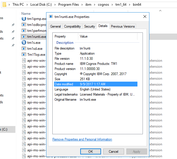

Sorry for a bit confusing. I thought I can copy tm1runti.exe from C:\Program Files\IBM\cognos\tm1_64\bin64 on TM1 10.2.2 server and put it into PA2.0.3 environment to make it work. After testing, it apparently doesn't work. I didn't do the upgrade on existing 10.2.2 but just a new fresh installation of PA2.0.3.
Can I have your version info of tm1runti.exe on PA2.0.3 server? Here is mine, just want to double check if IBM has upgraded it or not.

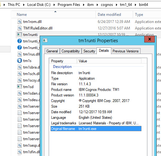

Macsir, got it; our 10.2.2 environments are gone so not able to test that for you. Pictured below are file details for runti, it's 11.1.4.3 I guess.

ascheevel wrote: Wed Jan 10, 2018 12:25 pm Macsir, got it; our 10.2.2 environments are gone so not able to test that for you. Pictured below are file details for runti, it's 11.1.4.3 I guess.
Thanks, buddy. Yes, looks like mine is older than yours and IBM did fix the bug in your version.
