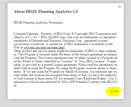

Re: Where is data source for TI in PAW?
And is that the right place to check PAW version? 2.0.25?

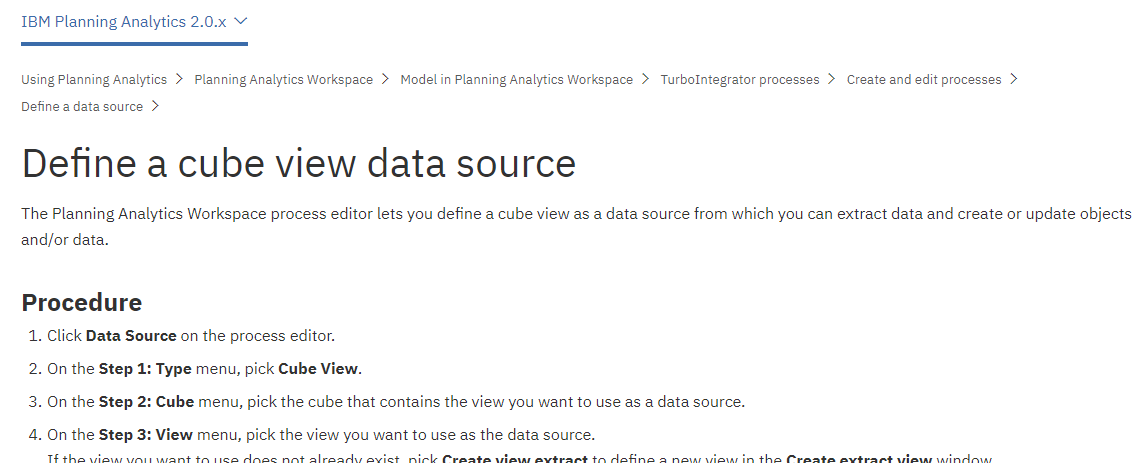

Guys, exciting! The feature is released in 2.0.29 version. Check the link below.
https://www.ibm.com/support/knowledgece ... _sc29.html
I am exciting to set this up soon.
