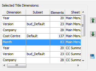

I have tried combining all the reports into one workbook, but in the print report wizard, it still asks me to select the same dimensions 9 times (see attached snapshot. For instance, Year dimension appears 9 times). Other than that, the selection of subset doesnt accept temporary subset, i have to create a subset for the user to pick, but I dont know which subset other than the cost centre will the user pick, so i basically have to create a subset for each element in the dimensions. Is my understanding right?

If dimensions are appearing more than once it's because you have multiple SUBNM formulas in the workbook. Just get rid of the extra SUBNM formulas by pointing the cell in Excel to the first. For example, if you are going to print the report for the same version in all tabs, leave the SUBNM formula in the first tab and go the cell in all the other tabs that have the same SUBNM formula in it and point it to the cell in the first tab. Best practice for organization would be to add an extra tab in the workbook and have all your user selections in that tab. Then consolidate all the identical SUBNM's into one.
