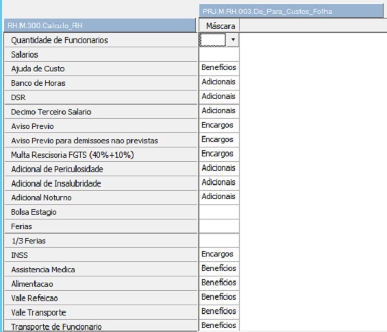

There is a cube of human resources (cube 1) with some metrics and I also have a lookup cube where each of the metrics of human resources cube has a expense classification, as image.
Then in another cube I am trying to do a rule where I do a DB from the cube 1, but on this DB when I am going to select the metric I would like to use the lookup cube.
How can I do this?

You can nest a DB() function within another DB() function.
So 1 of the arguments of the DB() function for the lookup cube, is again a DB() function for the metric.
Was that your question ?

Why don't you build a hierarchy in the dimension that is on the rows on your screen?
Wim, I think he is trying to accumulate cost lines, so not sure how a nested DB would help here? Although I agree, it is not too clear from the original post

Re: Cube Rule
Hi there,
I've tried to use DB inside another DB and it didnot worked.
I will put in a word file more details so you can understand better.
Thanks for helping me.
Jorge Rachid
Jorge Rachid

Re: Cube Rule
Create a hierarchy in the first cube's cost dimension, i.e.
Total
___Encargos
______Avisio Previo
And then the rule should be obvious, hopefully
This will work as long as it is a n:1 mapping
Total
___Encargos
______Avisio Previo

Hi guys,
I understond this point of creating the hierarchy and then using DB.
But I would like to know if it is possible to do something using the look up cube, where I set the expense classification for each metric of the cube.
Thanks for helping.
JR
Thanks for helping.
JR

Re: Cube Rule
technically it is possible yes, you can follow the logic of accumulation links, used by Performance Modeler, and build similar control/technical cubes to support what you want to achieve.
