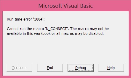

Problem Statement:
As soon as I run the .VBS Script, it gives me an error: Cannot run macro n_connect.
Error pops up when I try opening Excel ActiveForm through .VBS Script
Howevere, I would like to let you know that, when I open (Double click) ExcelActiveForm.xlsm it doesnt throw such errors. Everything runs flawless and ActiveForm is recalculated.
I need your suggestions to get rid of that error. Any inputs for this issue will be highly appreciated.
Thanks a lot!
Cipher.

Were you using the service account to run this?
