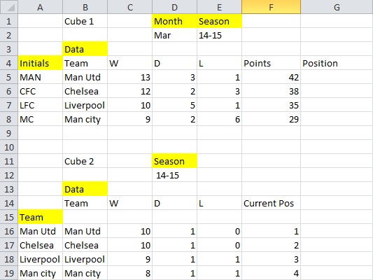

So if Team (Element in a dimension) in cube 1 matches Team (element in a dimension) in cube 2 matches then
get the data in Current Pos (element) and stick it in Position in cube 1
Hope that helps

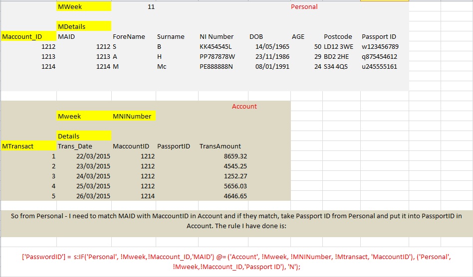

Ok, the following image is what I have at the moment
Thank you

Mithun.Mistry1103
Posts: 63
Joined: Thu Jul 03, 2014 1:14 pm
OLAP Product: cognos
Re: Rule issue
Post by Mithun.Mistry1103 »
Hey declanr
Thats worked for me, thank you....what I changed is shown below:
['PassportID']=S:
Db('Personal', DB ( 'Account', !MWeek, !MNINumber, !MTransact, 'MaccountID'), !Mweek, 'Passport ID');
Because of the dimensional order. It makes sense why we would do it this way that you mentioned as its much easier but what could I have done in terms of the @= or will that just not work for what I am trying to achieve? As i Mentioned, it worked to a certain point then then collapsed.
Apologies if this is getting longwinded but Its just a learning what and why you would do it one way and not the other?

I can't say exactly as I assume the rule you've posted isn't the actual one considering it doesn't use the correct syntax and it refers to "PasswordID" which I think should be "PassportID"?
But:
['PasswordID'] = s:IF('Personal', !Mweek,!Maccount_ID,'MAID') @= ('Account', !Mweek, !MNINumber, !Mtransact, 'MaccountID'), ('Personal',!Mwek,!Maccount_ID,'Passport ID'), 'N');
If corrected syntactically would never work since you are using "!Maccount_ID" which doesn't exist in the "Account" cube so it won't ever be able to find anything for it (and therefore the rule wouldn't save.)
As such you need to get the !Maccount_ID via a DB into the "Account" cube at which point the logical comparison would ALWAYS be true and therefore redundant e.g.
DB('Personal', !Mweek, DB ('Account', !Mweek, !MNINumber, !Mtransact, 'MaccountID'), 'MAID')
would always equal
I am assuming that the measure "MAID" is just a lookup to the dimension !Maccount_ID from the screenshots and that has resulted in the statements above.
But on that subject I am intrigued as to why you would bring the dimension element name into the cube as a cell value; since you are then going to create many duplicates of data that probably aren't needed - since you can just look at the dimension element.
