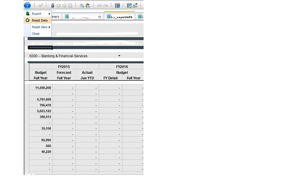

I am in the process of releasing our budget model and require an easy way to clear all test data contained within TM1 Application.
I have been able to release ownership across all nodes for a particular application via process: }tp_reset_state, however
getting rid of the all the old data ( highlighted in blue ) cannot be deleted.....
I have had a look at all the processes but cannot find which one to use. I cannot seem to find the process I'm after using these
hidden TI processes.
Is there a way to get around this? I can obviously select the top node within each deployed app and choose to "reset data" within
each app, but this would be too time consuming. Please help!
Sceenshot of the "reset data":
