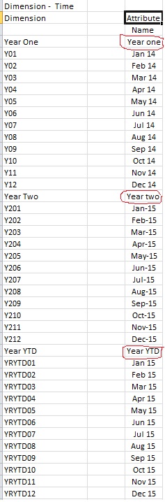

I believe it will work as I have tried it and the errors that are occuring are refering to the strings in the attribute, as some of the strings dont have numbers as they are titles. It says it cannot convert strings to real numbers which makes sense. And the other cause is the uniqueness of the data...so 15 would need to change to 16 first before 14 can change to 15 ..
The image is a example of the attribute in the dimension that we have ..
Thank you for your time and effort and sorry for the inconvenience
