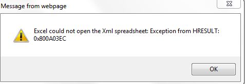

we are getting an error as shown in screenshot (attached in this post) , while doing export to snapshot from TM1web for one particular sheet. For other sheets, this feature is working fine and we are getting data exported to excel. I read multiple posts on the forum, and tried some options like below mentioned in those posts already, but no LUCK yet:

Thanks Duncan for the suggestion. i tried that too, but it didn't worked because the .xlsx sheet somehow got corrupted and thats why none of the above solutions worked in this case. Copied a working version of this .xlsx file from a backup, and now snapshot to excel from TM1Web works fine.
