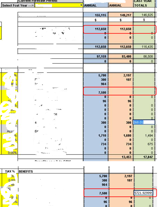

In TM1 Web: Values from cube (or excel calculations) that are 3+ decimals do not 'render' on the TM1 Websheets - they display as blank cells. If you double click on the cell (as if to update) OR export the websheet to Excel (snapshot or slice) values do appear, however. See screenshots attached.

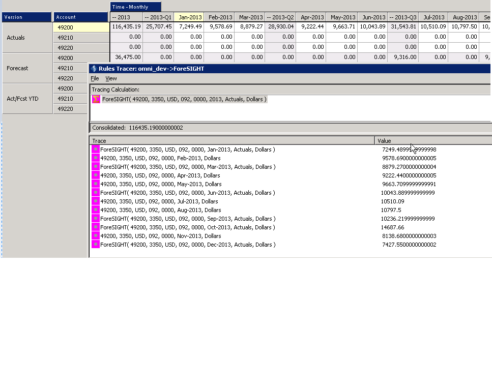

In Perspectives/Architect: When you type a value (ie 7249.49) into a leaf cell and then right click on the consolidation above and choose calculate, the value you typed in will be carried out to far more decimal places than you originally typed (see screenshot attached). I have not been able to confirm if this is only the case when the user originally spreads a value and then tries to 'tweak' certain cells or if it is for ALL manually typed in values.
The two issues are related in that for any cell with 3+ decimals in the cube they are not displayed on TM1Web.

Websheet view from TM1Web 10.2.2, circled areas show non-rendered value when seen from web.
