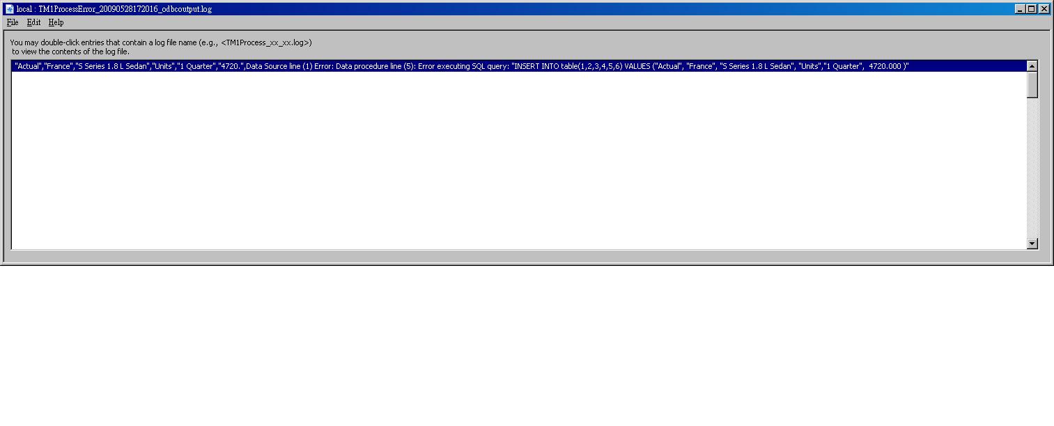

and I got this error .. got any idea ??
ODBCoutput problem
ODBCoutput problem

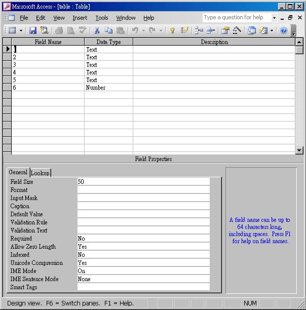

- table design
- DB design.JPG (66.4 KiB) Viewed 4175 times
- error
- error.JPG (57.47 KiB) Viewed 4175 times

You are trying to insert a numeric value in field 5 and are missing the value for field 6.
