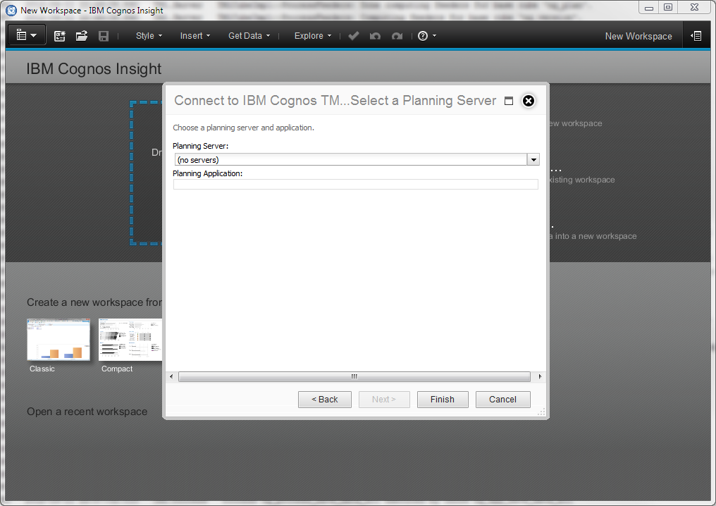

Re: TM1 V10.1 Release; New features And issues
Actually I was very thrilled with CI when it was first shown. But soon I found the non-admin user issue. I thought it must be a setting I'm missing, but after several reads and posts on http://www.analyticszone.com things were clear. CI at the current state is not much of use for our users, as they can't even see a planning server without admin access, not even from a CDD file an admin creates. Bummer!
http://www.ibm.com/developerworks/data/ ... ge627.html
Plus to make things worse, CI will not even connect to TM1 when you have Integrated Login enabled!
https://www.analyticszone.com/forums/ht ... acadd08a63
- Capture.PNG (370.98 KiB) Viewed 27477 times
Hmm... should have joined a long time ago - was a long time before anyone reported the rumor that CI needs admin rights to work with TM1.
CI does NOT require admin rights to work with TM1 - have posted more details in the analyticzone, but would rather not have the rumour float around.
The administrator just needs to set up and application, and the users entering via the application portal will be able to author their own workspaces (Central application), or be restricted to the admin's view of the world in the case of Reponsibility & Approval apps.
A Central application should only take a few moments to deploy for the admin, after which, only user rights are necessary, and their permissions are respected in the client - they just need to launch from the portal.
Also, the admin could just send them a .cdd file to connect from. The idea is generally that the admin has a level of oversight on what is consumed by the users before they go at it, in the same way you might point users to a package to build reports from, rather than given them a connection string to the database...
For more, see https://www.analyticszone.com/forums/ht ... 3529ad0b75
For Mems - Try TM1 10.1.1 FP1 with CI 10.2 FP1 - and if you don't need it, turn of "Show Related Members" as well - this could cause pain in ExplorePoints, the Explor pane, etc...
