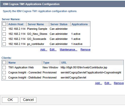

I think you may be onto something there. When I went back into the Applications Web portal and hit OK again it threw an error; specifically "An exception error occurred on the server... .com.cognos.ccl4j.exceptions.CCLNullArgumentException (root com.cognos.ccl4j.exceptions.CCLNullArgumentException: [CCLMsg: system text='Argument value is null']"
Yup, that's user friendly.
Alan,
It took me a few hours to figure out the problem. For Application Web, you need a FQDN (Fully Qualified Domain Name) specified in the URL in order to work, else you will get the unfriendly Java exception. You can't use IP Address, "Localhost".
You will notice the default generated URL in the TM1 Application Web is using FQDN. (Under IBM Cognos TM1 Application Configuration).
For the rest like Operation Console, TM1Web...they all work with IP Address. Why so special about Application Web, think it's a inherit property from the old Cognos Contributor era.

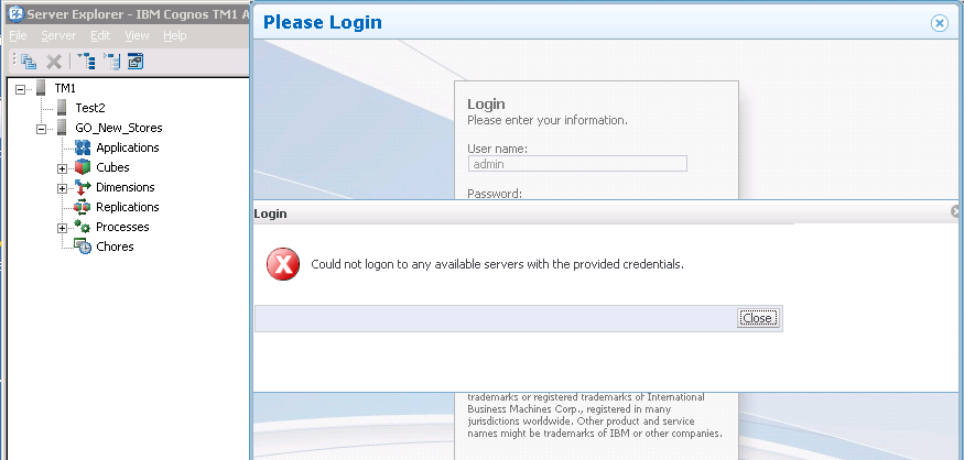

I am stuck with the same problem.
But to my surprise, the first step I have tried deploying a sample application 'GO_New_Stores', i have successfully deployed it using the Performance Modeler ICON in the Contributor. I can now see this application in the contributor with all the values intact.
But when I'm trying to create a new sample/test application, this small annoying thing does not show up the available servers - I have tried everything possible to make sure the server is available and running.
It shows only the one application 'Go_New_Stores' that has already been deployed.
Any suggestions on this would be really greatful.

Did you define the new TM1 instance in IBM Cognos TM1 Application Configuration ? You need to do that.

Even after logging in by clicking 'Log on As' as shown in the screenshot in my previous post, I am unable to see other servers though they are started and running (these servers Can be opened and are workable in Architect). I am not even able to see the other sample servers - SData and Planning Sample, leave alone the servers which I have created!

You did this ?

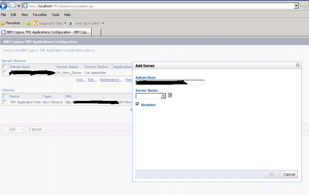

But I am unable to add any server. It shows disabled.
Tried by removing the previously deployed application 'GO_New_Stores' as well but to no avail.
I have tried by giving the numeric IP, the Admin Host name as well, tried enabling and disabling the 'Disabled' .. all possible options.. :|

theblackdawn wrote:Thanks for the reply kangkc..
Do you have the same username/password combo for all servers? (The ones that have already been added and the new ones you wish to add)

Not Really, but atleast the Sample Servers (3 of them) have the same userid/pwd .. right? So, if I am logging in for GO_New_Stores, the SData and Planning Sample must be visible... ?
But I'm not sure.. I have never done such things for 10.1 atleast. I used to login through PM and used to create a new application and deploy that. Was I doing wrong all the time :( ?

Not sure this is the right way. What I did to add in new instances:
1. Create the folders for sdata/logs
2. Copy the default tm1s.cfg, modify it according to the new instance and place it in the Sdata (some IBM APAR suggested this)
3. Add this new instance using IBM Cognos Configuration (fat client)
4. Make sure instance can be started and login using Perspective
5. Change the Admin password to "apple"
6. Navigate to http://your server:9510/pmsvc
7. Start up "IBM Cognos TM1 Applications Configuration"
8. Add the new TM1 instance
9. Once successfully added, you can now go back to Perspective and change the admin password, login again to IBM TM1 Application portal using the new password and deploy your apps.
This may not be the correct steps and rather strange to me but as long as it works for me.
