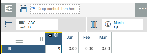

Question #11:
What will happen when data is entered to consolidated zero cell? For example:
Image 49.png (8.55 KiB) Viewed 43510 times

Post by ascheevel »
I'll say it depends, but the default behavior since 9.5.2 is that the value inputted at 0 value consolidation will be spread evenly amongst the leaves. Since there are 3 leaf children, there will be a value of 3 in each month. If the TM1 admins have been bit one too many times by users spreading on zero at a very high level and they're on a version >= 10.2.2, they may have set the ProportionSpreadToZeroCells cfg setting to False which will cause an error popup when the user tries to spread on zero.

Post by MarenC »
Am I the only one who has made this the law!

Post by Elessar »
Correct answer:
I'll give a link to ascheevel's answer: viewtopic.php?p=83320#p83320
Nothing to add

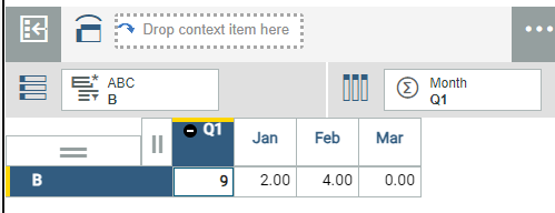

Question #12:
What will happen when data is entered to consolidated non-zero cell? For example:
Image 50.png (8.9 KiB) Viewed 43396 times

Post by ardi »
Data will be spread to leaf cells proportionally with existing values.
In this Case:
Value of January will change from 2 to 3, and value of February will change from 4 to 6. Value of March will remain zero

Post by MarenC »
Assuming Consolidation TypeIn Spreading is not set to Deny then what ardi says (assuming the user wasn't an Admin)!

Post by Elessar »
Correct answer:
Value will be spread to non-leaf cells proportionally if a user has admin rights or if Consolidation TypeIn Spreading is not set to Deny.
