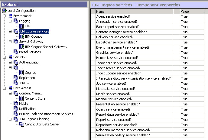

For those of you who are not using BI for reporting and only for the CAM functionality, have you managed to turn off any of the default BI services that get installed with a default BI install routine? I'm trying to get only the CAM functionality in place and turn off any other unnecessary overhead as these services will be living on an existing TM1 server.
Cognos BI 10.2.2 services
Cognos BI services.jpg (102.25 KiB) Viewed 7884 times
Many thanks.

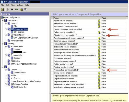

Turns out through a bit of trial and error I can get CAM running with only these services enabled:
CAM Services.jpg (68.66 KiB) Viewed 7859 times
