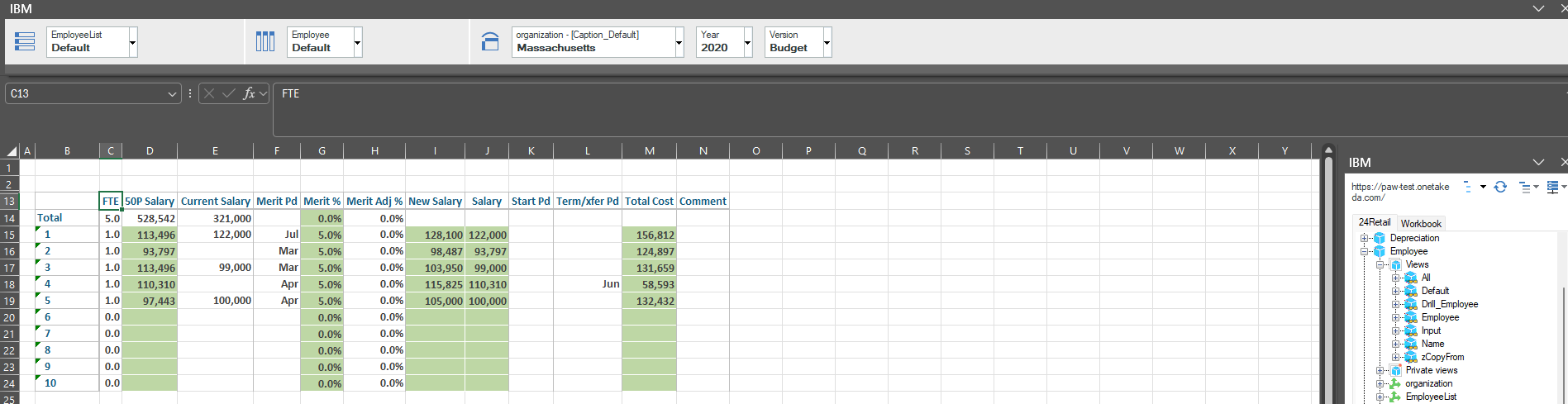

Question #51:
I have an Exploration view. I Need to display attribute for each element in row ("employee name" in this example). How can I do this?
Image 269.png (63.08 KiB) Viewed 91134 times

I would add a With Member expression to the MDX to retrieve the attribute.
WITH MEMBER [Employee].[Employee].[Emp Name] AS [Employee List].[Employee List].CURRENTMEMBER.PROPERTIES("Employee Name")
Then add the above to the Select Statement in the appropriate place.
Maren

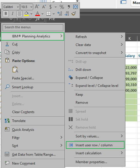

Correct answer:
Well, it was more a PAfE user's question, and I've expected answer with "Insert user column" + DBRW(}ElementAttributes).
Image 1.png (24.54 KiB) Viewed 90856 times
But, Maren has proved his MDX knowledge again, so:
Winner of this round is MarenC!
