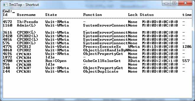

I can not end any process execute or object duplicate .
there is one way... restart service.
is there any solution to this issue?
I have TM1 9.0 SP2
this print screen how can i end user process execution or object duplicate
