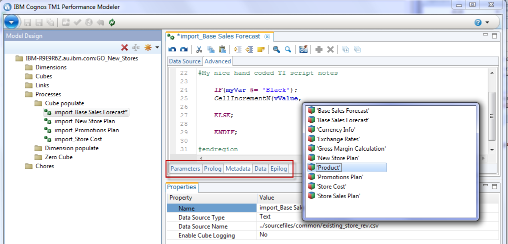

At last - the TI scripting editor gets a makeover..
Agree those new smaller grey/blue icons don't help with usability. Perhaps the IBM UI people forget they were wearing these:

Amen.rollo19 wrote:I guess prototyping gets easier/faster and can now involve Joe Analyst but no replacement for skills in a larger production environment.
Heh, I liked that one. I find the icons easier to identify now that I know what I'm looking at but they're still not as easy as the old N and S. Somewhere along the way IBM forgot that the whole purpose of an icon is to provide the user with instant recognition of what it is that they're looking at. It's still a design fail.rollo19 wrote:Agree those new smaller grey/blue icons don't help with usability. Perhaps the IBM UI people forget they were wearing these:
In Performance Modeller it does; it doesn't in Perspectives. I had yet to look at Performance Modeller. Oh, right, now I know why!rollo19 wrote:At last - the TI scripting editor gets a makeover..
Unlike Web, which I haven't been able to launch at all yet, Performance Modeller (or perhaps I should say Applications) did launch after I entered the butt-ugly URL address. "Intuitive" is not the word that came to mind and it certainly won't be the word that comes to mind for newbie users who will be confronted with (to them) unintelligible messages about things that are missing from their tm1s.cfg file. (In the sample databases, no less. The sample databases that Iboglix provided and which you would therefore expect to be configured to run with Performance Modeller.)
So what happens when I go to launch Performance Modeller? It asks me whether I want to install it. Yes, I have to freaking install it first. Gee, here I was thinking that I had selected all of the options during the initial installation and that it should sodding well already be installed. But no, I have to save the .msi somewhere and run it. At which point Norton warns me that fewer than 5 users have installed it and with big red flashing lights almost breaks out into a chorus of "Don't Pay The Ferryman, Don't Even Fix A Price, Don't Run This Installer, It May Not Get You To The Other Side!". I tell it to go ahead anyway. I'm now at the point where it's asking me to open provagent.cogrcp_modeler which it's suggesting that I open with IBM Cognos RCP Application Updater. Sitting... watching... hard disk spinning... nothing... still nothing... oh, splash screen!
OK, I'm in. Oh fabr'us day, it actually has search and replace, comment/uncomment and a few other niceties. Firing up this thing just to get to the updated editor should be lots of fun, rather like firing up a 44 class diesel locomotive to drive down to the local shops, but once you're in it'll certainly be an improvement over the Perspectives one.

OK, first off in Performance Modeller (which I refuse to spell with 1 "L" because where I come from that puts a red squiggle under it) the chore icons definitely don't change when a chore is active. Steve Vincent, this one's for you.Alan Kirk wrote:Still, I'll be interested to try out the new editor and see how it performs.
There's another cute quirk. You know how there are some chores that you don't want to schedule, ever, so you'd be quite happy to leave the schedule as 0/0/0/0 but you can't because the chore dialog insists that you enter a non-zero value? Well, that one's still there.
But you know how you would put in 999 days as your way of saying "Get out of my sodding face and get on with it"? OK, you can't do that in Performance Modeller. If you set (only) the days, you can only set a value from 1 to 365. (Of course even a P.O.S. like Quicken can do schedules which are annual (so leap years (oh! like this one!) don't affect the schedule), weekly, fortnightly, nth Thursday of each month, etc, but not TM1 chores. But then Quicken scheduled transactions are done in local time so what would they know?) Where was I? Oh yes, you can still set 999 days in ye olde Server Explorer but if you try to work with a chore like that in PM you get an error message telling you that the input is incorrect. (Not what the valid range is mind you; I discovered that from trial, error and guesswork though perhaps it's in the manual somewhere... just that it is invalid.)
Why the difference? Probably a "left hand/ right hand" thing. What was that thing we were saying about "same and consistent functionality across all interfaces"? Never mind...

It's a constant source of inspiration to me when someone does the bare minimum that needs to be done, and calls it "Progress". So consider me inspired.rollo19 wrote:At last - the TI scripting editor gets a makeover..
10 years late, we have Find and Replace. Ah, and what an implementation it is. First, the usual MS Office (and many Windows applications) key combinations of [Ctrl]+[F] and [Ctrl]+[H] haven't been implemented. You can only get the dialog from clicking on the little magnifying glass icon which looks not quite like the magnifying glass icon that represents "Goto Line". But who cares if they're intuitive, as long as they're pretty. Ooops, I just hit [Ctrl]+[H] again! Must move my hand over to the mouse because that's more efficient than a keyboard shortcut, don'cha know.
Now, if I have a block of text highlighted and I select the Replace tool, do you think it's possible that I may want the replacement to be done within that block? Yeah, me too. The designers of the VBA IDE, misguided fools that they are, thought likewise and implemented it accordingly. But this tool doesn't. If I select Replace All it will replace all occurrences of the word in the tab, not just those in the highlighted block. If I just select Replace, it will replace the first instance that occurs after the block. So remember to put your cursor before, not on, the first word that you want selected, then repeat for each word in the block that you want to replace it in.
Ah, here's another block that I want to do a search in. [Ctrl]+[H]... oops, I mean, click pretty web-like icon that looks like the other pretty web like icon. Oh lookie, unlike what you get in Word (or most programs that I use) the dialog hasn't remembered the last search that I did, so I have to enter it in again.
Ah, a useful feature; when you hit [Return] after a function then it will automatically put the semi-colon after the line. Well done.
Oh, wait... but when you get to the end of a variable assignment line (like s = 'y') then the content assist dialog will appear. So better remember to hit that closing semi-colon then, because otherwise you'll get
s = 'y'ABS(Speaking of which, the Content Assist dialog is another minimalist attempt. 10 years in the making, it hasn't quite reached the efficiency of the Intellisense system that MS had in VBA back in Office 97. Want to do an asciioutput? Fine and dandy, start typing Ascii, then press [Ctrl]+[Space] to bring it up (oooh, an actual keyboard shortcut!!! Slick!) and hey presto, you're told that the first argument is a string, and the second argument is a string, and there are more arguments which are probably strings as well. None of this mollycoddling of giving you descriptive names explaining (or at least hinting) what each argument is the way Intellisense does, this is a Content Assist dialog for Real Men (TM Iboglix Software Corp) where you get to manually look up what each argument is and what the function does. I say "manually" because (again, unlike the 15 year old Intellisense technology), you can't select the keyword and hit [F1] and have the relevant help page appear. Of course, if I can never remember which of the 7 separate help documents the relevant entry is in, how can I expect poor old Content Assist to?
You still can't Save As over a process that already exists; that was pretty much expected. Disappointing, but expected. At least unlike the Find dialog, the Save As one is populated with the existing name so that you can modify it instead of having to retype the whole thing. (Useful if you're saving with a similar name.)
I shall continue my exploration later, when I again get in some snooze time waiting for Performance Modeller to launch after (yet again) presenting me with the dialog asking me to me to open provagent.cogrcp_modeler with IBM Cognos RCP Application Updater. (Granted, I haven't rebooted since installation; I'm hoping that will go away after I do because the diesel loco that is Performance Modeller takes long enough to fire up as it is.)
