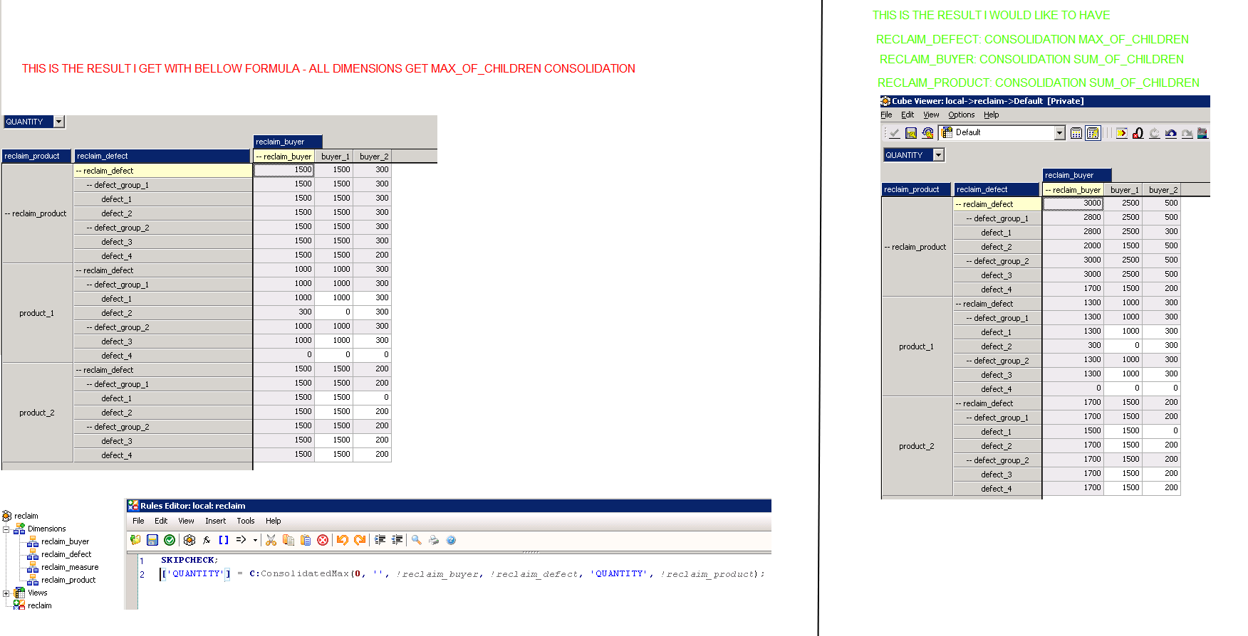

I have installed TM1 v9.5.2 and I have tried formula:
This kind of formula colsolidates ALL of dimensions as maximum of children. How to write such a formula that only dimension "reclaim_defect" will have a logic of maximum of children, but other two dimensions like reclaim_buyer and reclaim_product will use a sum of children consolidation?
See attached picture for simple sample.
P.S. I suggest to open picture in another window.
['QUANTITY'] = C:ConsolidatedMax(0, '', !reclaim_buyer , !reclaim_defect, 'QUANTITY', !reclaim_product );See attached picture for simple sample.

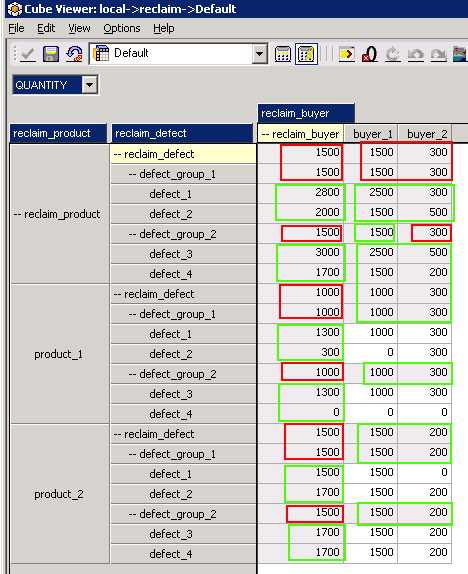

abcuser
- Posts: 133
- Version: 9.5.2
- Excel Version: 0
Re: How to consolidate dimension with maximum of children?
Andy, I have tried your code and it does not produce correct values. I am quite a newbe at TM1 server. Can you please write what do you mean by ConsolidateChildren?
I am attaching a picture: green rectangles correct values, red rectangles incorrect values.
I am also attaching zip file with three .dim files and a .cub file to reproduce the sample.
Any help is greatly appreciated.
- reclaim.png (15.6 KiB) Viewed 8038 times
- rekl.zip
- (1.19 KiB) Downloaded 610 times

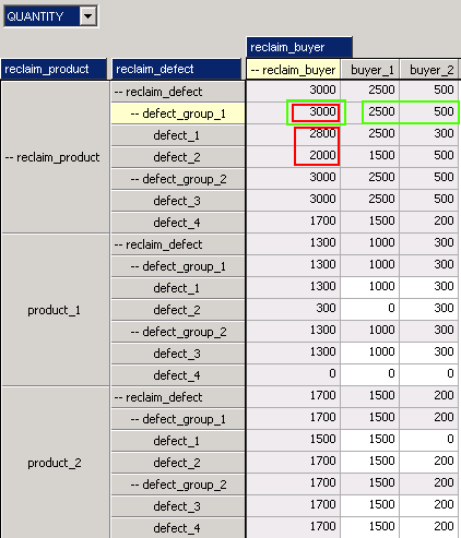

abcuser
- Posts: 133
- Version: 9.5.2
- Excel Version: 0
I have solved the problem. Solution is bellow formula. Dimension order should also be changed!!! by Cube | Re-order dimensions and move dimension reclaim_defect to the LAST bottom position. The order ob dimensions is vital, if not reordering dimensions the result is not correct.
Little bit more explaining: Getting deeper into the problem I have found out that I need to redefine requirement! Why? Because summing of one dimension and maximizing on another does NOT produce the same value (I haven't expected this behavior at all)! Look at attached picture. If aggregation is done using maximum of children on relcaim_defect dimension then max of 2800 and 2000 is 2800 (see red rectangles), but if default sum aggregation on buyer dimension is done then summing 2500 and 500 is equal to 3000 (see green rectangles). So aggregations on reclaim_defect and reclaim_buyer does not produce the same value! I have discussed with end-user and found out that maximum of children on reclaim_defect dimension should only be done (on all levers of reclaim_defect) but only on the lowest levels of other dimensions (level = 0). For upper-levels of dimensions buyer and product there should be a sum aggregation.
['QUANTITY'] = C:
if(
ELLEV('reclaim_buyer', !reclaim_buyer)= 0 &
ELLEV('reclaim_product', !reclaim_product)=0
ConsolidatedMax(0,'', !reclaim_buyer, !reclaim_defect, 'QUANTITY',!reclaim_product)
STET
- reclaim_defect.png (10.91 KiB) Viewed 8024 times
