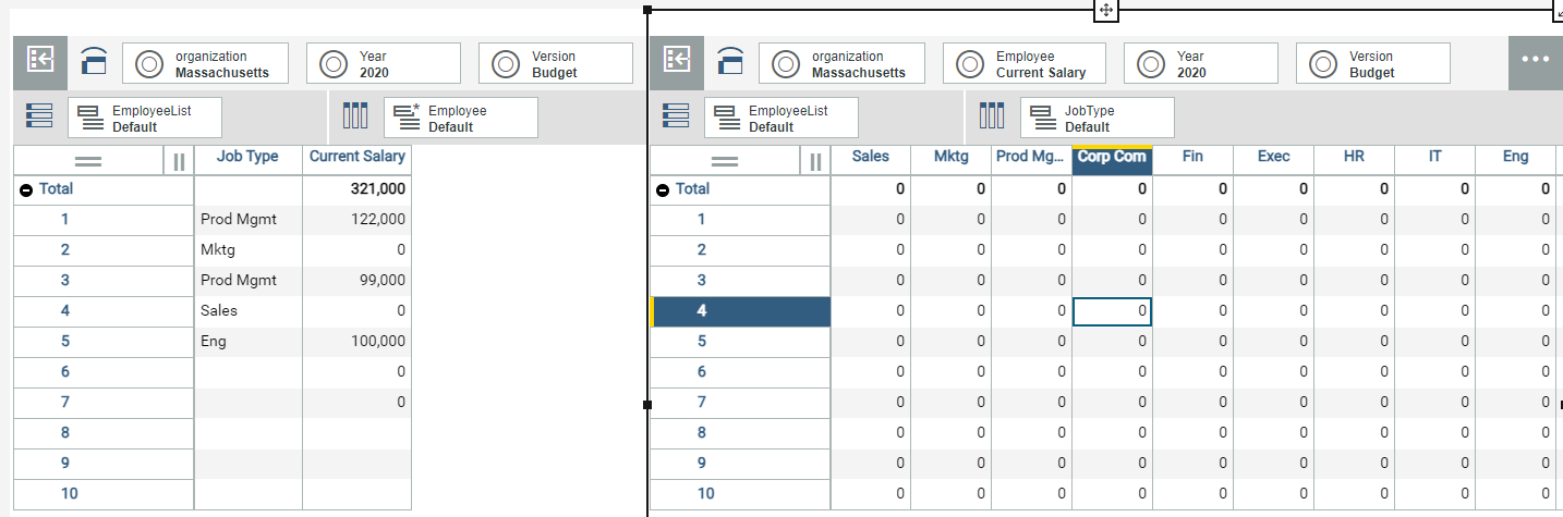

There is "Employee" cube with employees list, their job types and salaries (from 24Retail sample). Picklist for Job Type uses subset with alias enabled (element names are different). I've created a new "Employee analysis" cube with extra "JobType" dimension.
Write a rule (without feeder. Spoiler: this will be the next question) to transfer data from "Employee" to "Employee analysis" cube.
Dimension order in "Employee" cube:
  • Organization
  • EmployeeList
  • Year
  • Version
  • Employee

I am assuming the Employee analysis dimension order is the same as the Employee Cube order.
['Current Salary']=N:
If( DB( 'Employee', !Organization, !EmployeeList, !Year, !Version, 'Job Type' ) @= ATTRS( 'JobType', !JobType, 'Alias' ),
	DB('Employee', !Organization, !EmployeeList, !Year, !Version, !Employee ),
	STET

Correct answer:
SKIPCHECK;
['Current Salary'] = N: IF(DIMIX('JobType', !JobType) = DIMIX('JobType', DB('Employee', !organization, !EmployeeList, !Year, !Version, 'Job Type')),
	DB('Employee', !organization, !EmployeeList, !Year, !Version, !Employee),
	0);
Using DIMIXes is better than comparing alias, because you do not need to know alias name here.
Winner of this week is MarenC!

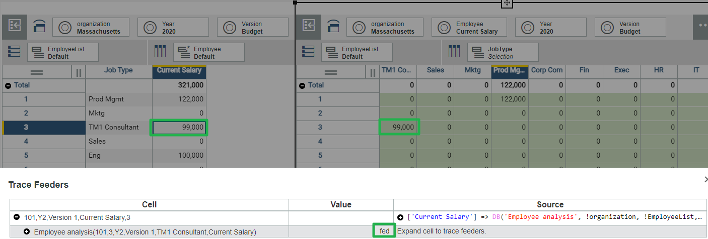

I've written a feeder from source "Employee" cube:
['Current Salary'] => DB('Employee analysis', !organization, !EmployeeList, !Year, !Version,
	DB('Employee', !organization, !EmployeeList, !Year, !Version, 'Job Type'),
	!Employee);
It works fine until user changes Job Type. The cell does not sum up to Total. But "Trace cell" states that source cell does feed target cell. What's going on here? How should I write a correct feeder?

Also feed from Job Type - it’s a string cell so any change to it will cause FEEDER to trigger and re-trigger:
['Job Type'] => DB('Employee analysis', !organization, !EmployeeList, !Year, !Version,
	!Employee);

OK! But why does "Trace cell" show "fed" with my feeder?

Elessar wrote: Sun Feb 18, 2024 12:20 pm OK! But why does "Trace cell" show "fed" with my feeder?
Source is feeding, but not to the target cell shown in the function, which is seemingly a live functional statement.

Correct answer:
Firstly, feeder from numeric "Salary" do not know that Job Type is changed, and feeder will not re-fire after Job type is changed.
Secondly, "Trace feeders" do not check if target cell is fed. It checks if current feeder written in rule, with current data (like Job type), should fire a feeder or not.
The correct feeder will be:
FEEDERS;
	'Current Salary');
Winner of this week is Adam! (I believe "!Employee" is a typo in your answer?)

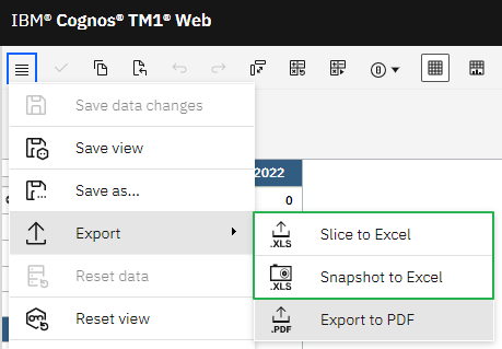

Question #9:
What do Slice and Snapshot to excel do? What is the difference? What software is needed to use files generated by each button?

Post by MarenC »
  • Slice exports the data in the view to excel and allows for write back to the view/cube (via DBRW formulas). Note that the values will be the current values and not the values at the time of the slice.
  • Snapshot exports the data in the view to excel as static values.
Need excel for snapshots.
Need client excel add in for slices, ie Perspectives or PAX (not tried with PAX so assuming this!).
Spreadsheet services running for slices I assume.
