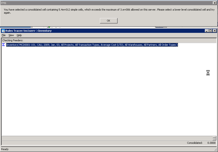

Ok.. I have followed your instructions and it seems that no matter what day I select or what value appears, I do not get the option "Trace Feeders" as you can see from the attached screenshots.

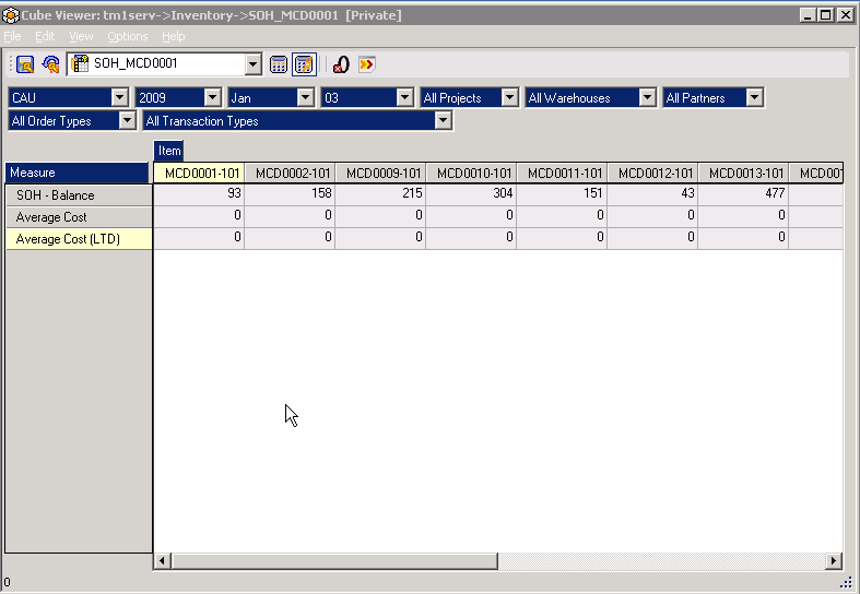

I have attached a copy of the view that I am referring to. You can also see that when I right click on a cell I do not get the Trace Feeders option. And when I try and select "Check Feeders" I receive a message as displayed in the screenshot.
"You have selected a consolidation cell containing 5.4e+012 simple cells, which exceeds the maximum of 3.e+006 allowed on the server....."

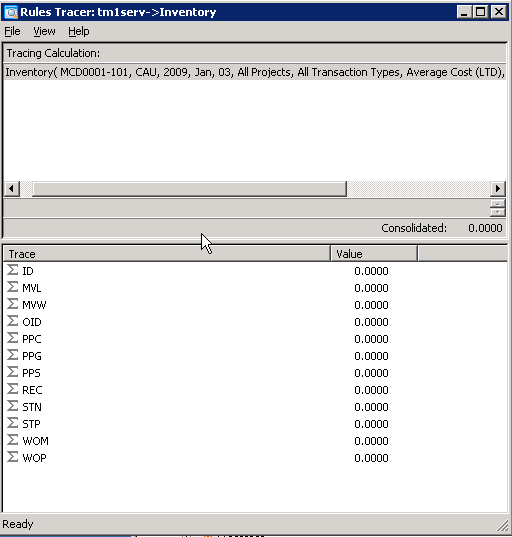

I have also provided you a screenshot of what displays when I right hand click "Trace Calculation" on Day "03".
In regards to C vs N levels. Basically from what I understand my view is allowing users to select a consolidation for elements such as Warehouse, Project, Partner, etc. However I imagine for the rule to work it would need to be based on the N level that such as Project 000000 and Partner 0000, etc. As all costs are stored against these elements. And from what I understand EV requires that the rules all be N level based.
Thanks. Damien
Thanks. Damien

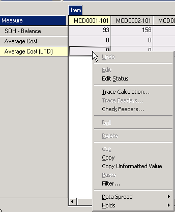

I forgot one screenshot as attached.
Damien
Damien
- inventory_cube_check_feeders.gif (9.41 KiB) Viewed 10461 times

The reason that you don't get trace feeder is that you are looking at the C level.
A golden rule for any kind of development of rules and feeders is to only look at the N level, the C level should take care of itself as it's just a sum (usually).
You can only really test the behaviour of your system so at the N level of the cube.
Can you repeat but with all the cube references at the N level.
Cheers
Cheers

Re: Obtain last non zero value in a date range
Try "Check Feeders" as opposed to "Trace Feeders".
Check Feeders is for the calculated measure that is being fed and will tell you if any cells are not fed (blank result = all OK). This can be done at C level.
Trace Feeders traces from the value doing the feeding and shows you where the feeder is going to.

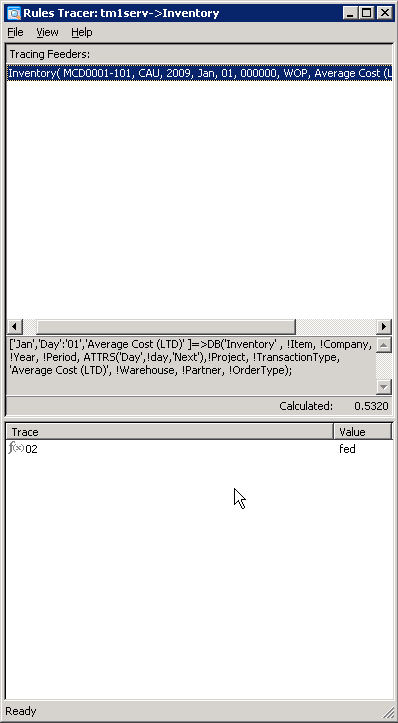

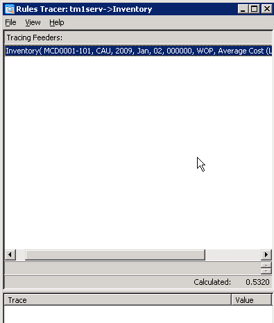

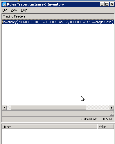

Please find attached the screenshots of the Trace Feeders for Days 01, 02, 03 at the N level. Hope this helps. Thanks, Damien
- InventoryCubeDay3.gif (5.29 KiB) Viewed 10434 times
- InventoryCubeDay2.gif (4.9 KiB) Viewed 10434 times
- InventoryCubeDay1.gif (7.75 KiB) Viewed 10430 times
Hi damien
We've managed to drop a feeder somehow, we need this one as well
['Average Cost (LTD)' ]=>DB('Inventory' , !Item, !Company, !Year, !Month, ATTRS('Day',!day,'Next'),!Project, !TransactionType, 'Average Cost (LTD)', !Warehouse, !Partner, !OrderType);
The above feeder is the main feeder for the system and the one that would break the feeder stack. The one with the date in are the extra ones we put in to get past the break points in the attribute.
Hopefully this will get Jan working and then we can look at extending for all periods.
Cheers,
Cheers,
yes, I get it now.. Crystal clear!
And therefore if any of those cells is not fed it will stop, for example if day 03 is not being fed, it will not be calculated and therefore no value will be returned and it will go no further and therefore the value for Day 05 will end up with zero.
Thankyou so much for your help.. I have learned so much about feeders and rules!
