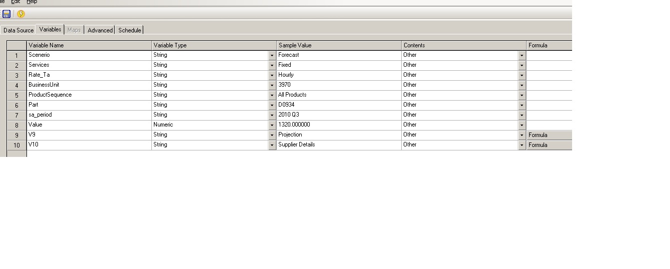

Thanks a lot Michel and Declar.The variables are declared as strings only,Strangely when I changed the variable"value" from Numeric to String the process ran successfully ,I know the variable 'Value' should be numeric only.Could someone please let me know why the process is running successfully when value is changed to string type.Did anybody come across this before?Thanks
Data tab
      NVal= CellGetN('DU_SERVICES_REPORT',SCENERIO,SERVICES, RATE_TA, BUSINESSUNIT, PRODUCTSEQUENCE, PART,'Charged Current Year');
      NVal1= CellGetN('DU_SERVICES_REPORT',SCENERIO,SERVICES, RATE_TA, BUSINESSUNIT, PRODUCTSEQUENCE, PART,'Charged  previous Year');
CellPutN(NVal,'SSM_EXPENSES_REPORTING',SCENERIO,SPECIALITY,PA_EXPENSE,'BUSINESS UNITS',SEQ_DET,PART,'Charge Rate Year 0',sDim1CurEl,sDim2CurEl);
CellPutN(NVal1,'SSM_EXPENSES_REPORTING',SCENERIO,SPECIALITY,PA_EXPENSE,'BUSINESS UNITS',SEQ_DET,PART,'Charge Rate Year 0',sDim1CurEl,sDim2CurEl);
Variables Tab.jpg (92.44 KiB) Viewed 13516 times

What is the data source of the process? Is it a view of the DU_SERVICES_REPORT cube?

Thanks Robin,Yes it is view of 'DU_SERVICES_REPORT'.

Right - so does the sa_period dimension have any string measures?

Thanks again Robin,Yes it does have few string elements defined in them.Meanwhile I will also go through the link you provided.

BariAbdul wrote:Yes it does have few string elements defined in them
OK, so that's why this error occurs:
BariAbdul wrote: Error: Meta Data procedure line (0): Cannot convert field number 8, value "SLT" to a real number
If you only want to process the numbers in the cube, then you have to build a subset of just the measures that hold numbers and then assign that subset to the view that is named as the cube view being used by the process. If you want a mixed subset of measures, both numeric and string, then the link discusses it in some detail and has code snippets.

  #### ASCIIOUTPUT the data before the load
#ASCIIOUTPUT('\test2
##Copy source cube data to Target cube###
sDim1='Projection';
sDim2='supplier Detail';
sDim3='general  no';
sDim4='pa_urgency';
sDim5='pa_gross';
sDim6='inception';
sDim7='product_status';
iLoop1=1;
iDim1Siz = DIMSIZ ( sDim1 );
iLoop2=1;
iDim2Siz = DIMSIZ ( sDim2 );
iLoop3=1;
iDim3Siz = DIMSIZ ( sDim3 );
iLoop4=1;
iDim4Siz = DIMSIZ ( sDim4 );
iLoop5=1;
iDim5Siz = DIMSIZ ( sDim5 );
iLoop6=1;
iDim6Siz = DIMSIZ ( sDim6 );
iLoop7=1;
iDim7Siz = DIMSIZ ( sDim7 );
While ( iLoop1 <= iDim1Siz );
    sDim1CurEl = DIMNM ( sDim1,iLoop1 );
WHILE ( iLoop2 <= iDim2Siz );
     sDim2CurEl = DIMNM ( sDim2,iLoop2 );
WHILE ( iLoop3 <= iDim3Siz );
     sDim3CurEl = DIMNM ( sDim3,iLoop3 );
WHILE ( iLoop4 <= iDim4Siz );
     sDim4CurEl = DIMNM ( sDim4,iLoop4 );
WHILE ( iLoop5 <= iDim5Siz );
        sDim5CurEl = DIMNM ( sDim5,iLoop5 );
WHILE ( iLoop6 <= iDim6Siz );
         sDim6CurEl = DIMNM ( sDim6,iLoop6 );
WHILE ( iLoop7 <= iDim7Siz );
         sDim7CurEl = DIMNM ( sDim7,iLoop7 );
IF (CellIsUpdateable('SSM_EXPENSES_REPORTING',SCENERIO,SPECIALITY,PA_EXPENSE,'BUSINESS UNITS',SEQ_DET,PART,'Charge Rate Year 0',sDim1CurEl,sDim2CurEl,
sDim3CurEl,sDim4CurEl,sDim5CurEl,sDim6CurEl,sDim7CurEl)=1);
   CellPutN(NVal,'SSM_EXPENSES_REPORTING',SCENERIO,SPECIALITY,PA_EXPENSE,'BUSINESS UNITS',SEQ_DET,PART,'Charge Rate Year 0',sDim1CurEl,sDim2CurEl,sDim3CurEl,sDim4CurEl,sDim5CurEl,sDim6CurEl,sDim7CurEl);
     ASCIIOUTPUT('\\test_csv', DU_SERVICES_REPORT_MASTER',SCENERIO,SERVICES, RATE_TA, BUSINESSUNIT, PRODUCTSEQUENCE, PART,'Charged Current Year',sDim1CurEl,sDim2CurEl,sDim3
ENDIF;
IF (CellIsUpdateable(‘DU_SERVICES_REPORT_MASTER',SCENERIO,SERVICES, RATE_TA, BUSINESSUNIT, PRODUCTSEQUENCE, PART,'ChargedCurrentYear’,sDim1CurEl,sDim2CurEl,sDim3CurEl,sDim4CurEl,sDim5CurEl,sDim6CurEl,sDim7CurEl)=1);
CellPutN(NVal1, ‘DU_SERVICES_REPORT_MASTER',SCENERIO,SERVICES, RATE_TA, BUSINESSUNIT, PRODUCTSEQUENCE, PART,'Charged Previous Year',sDim1CurEl,sDim2CurEl,sDim3
ENDIF;
   iLoop7 = iLoop7 + 1;
END;
   iLoop6 = iLoop6 + 1;
END;
   iLoop5 = iLoop5 + 1;
END;
   iLoop4 = iLoop4 + 1;
END;
   iLoop3 = iLoop3 + 1;
END;
  iLoop2 = iLoop2 + 1;
END;
    iLoop1= iLoop1 + 1;
END;
rmackenzie
Posts: 733
Re: Copy between cubes
Post by rmackenzie »
BariAbdul, I think you are over-reaching. You should just try and write one TI where you can copy cube data from one slice to another. Once you've conquered that step, you can continue to the more complex operations e.g. mixing numeric and string elements in the copy process.
The code you presented in the last post makes it look like you simply have no definite idea about the dimensional relationship between the source and target cubes. Looping through multiple dimensions in the target cube and repeatedly posting the source cube value looks, well, indiscriminate. I'm sure one of our more direct colleagues can think of something more direct to say about this.
Until you're comfortable with the basic read-from-source-cube-write-to-target-cube stuff then perhaps you are biting off more than you can chew?
Robin Mackenzie
