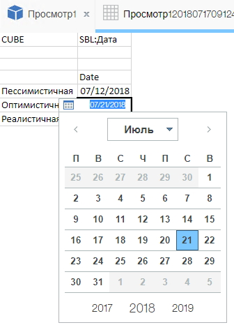

declanr wrote: Mon Jul 16, 2018 7:48 pm Hi Elessar, haven’t had a chance to check this but I know I’ve had it working in tm1 websheets - do you mean it doesn’t work in the cube viewer in TM1 web or do you mean websheets? Or both? If so what fp are you on.
Hi, I had tested this only in a cube viewer. Now i've tested the websheet: it does work (version 2.0.4)! Thank you :)
The format should be "c:mm/dd/yyyy":
