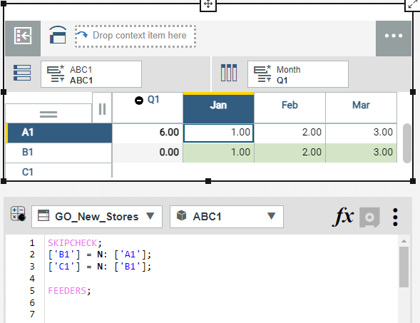

Question #41:
The cube and rule are shown on screenshots below. B1 is not fed. What will be in C1? Will it take numbers from not-fed calculated cells of B1?
