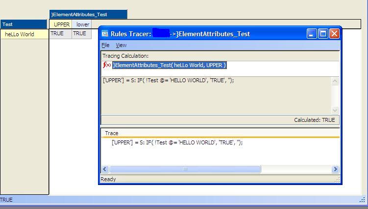

Re: effiecency of rule calc. If statment vs seperate area blocks
Kyro wrote:The primary reason to compare the dimix of two elements is to test where case sensitivity may be involved.
I agree with your comment that the Dimix statement in Shock's rule is unnecessary and I think I made that point originally (in fact the whole IF statement around the Dimix is unnecessary). But the statement quoted above isn't correct. Element information functions are not case sensitive or space sensitive just as element names are not case sensitive or space sensitive. If you need convincing see the attached example.

Uh, yup. Although I didn't realize that raw String comparison was not case sensitive :shock: , that's a little dangerous not to know, or is it just dangerous. Where does that leave you if your datasource has a case sensitive flag column?
Kyro wrote:Uh, yup. Although I didn't realize that raw String comparison was not case sensitive :shock: , that's a little dangerous not to know, or is it just dangerous. Where does that leave you if your datasource has a case sensitive flag column?
If it's a single character flag you can always use the Code function and compare to the ASCII code value(s)... alternatively the Scan function is case sensitive, and that could be put to use for that purpose.
