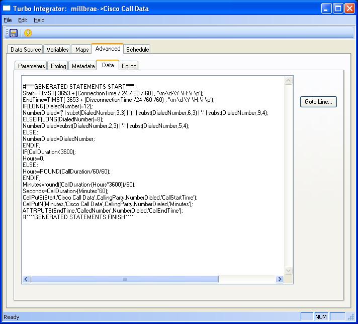

After Reading Alan's post on Long Strings in 9.0, and a few others that mentioned this error message in TI, I'm trying to figure out what I need to do in order to address the issue. Alan's been helping me piece together a TI process for analyzing Cisco Call Manager data (so far he's helped me convert C Construct Time and parse variables of varying string length).
I believe the System Stack Overflow error message may be due to the way that I coded the calculation for call duration, but based on the limited information from the TI log file, I don't have much to go on but speculation. A previous posting on this error message suggested that it may be due to a circular reference, but I combed my code and didn't see any.
Below is a screenshot of my Data tab. Perhaps one of you may have some eagle eyes and spot my mistake:
I'm not sure if it is poor "Variable" coding to have data variables that rely on values from other calculated data variables, but I'm just grasping at straws at this point.
At any rate, I was able to run the TI process without having the overflow error previously(I've been constantly revamping my TI process because the cube data still wasn't quite how I wanted it to be).
My humble thanks again for taking at look at my post. I appreciate any time you could spare to help me out.
