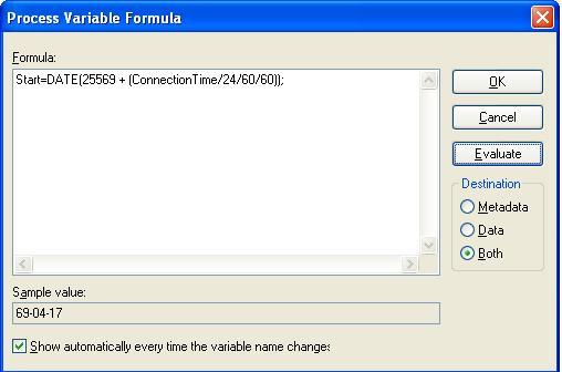

Below is what I have tried for the TI formula:
You can see the result. After looking at the DATE() function help file, it looks like the function only returns the date; it does not include the time of day. Ideally, I'd like the data to be in MM/DD/YYYY HH:MM format. Has anyone tried anything in a similar manner, or have any suggestions?

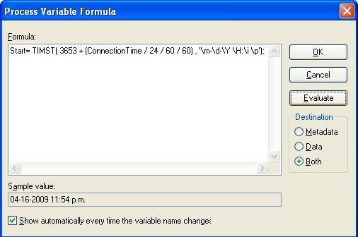

I'm not 100% clear on what value you're trying to return but the TIMST function would seem to be the solution to your problem. For example:
# Equivalent to the C timestamp, using local time. (The number of seconds since 1/1/70)
l = 1255607635.56;
# 3653 is the TI serial date of 1/1/70
s = TIMST( 3653 + ( l / 24 / 60 / 60 ) , '\m-\d-\Y \h:\i');
AsciiOutput ('Y:\Temp\s.txt', s );
This yields the output:
"10-15-2009 11:53"
Which is what the local time was here when I wrote that code.

Alan:
Thank you for the quick reply. That worked like a charm! Thank you for the great suggestion!
