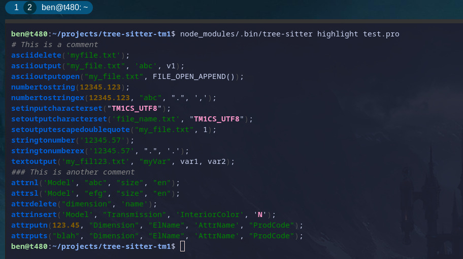

Although I no longer work with TM1, I still find that it's a great place to test out porting some of the latest technologies/capabilities. As some of you may or may not be aware, the world of syntax highlighting and source code parsing has advanced quite a bit and is slowly (but steadily) moving away from regex based matching to the concept of syntax trees. I won't go much further into the details as it could quickly derail the point of this post, but if you're curious, see the end of the post for more details.
I've begun work on building a language grammar for TurboIntegrator processes. The project (linked at the top) is a bit slow going due to how TI syntax works, but it's coming along. Unlike other languages, there's not a whole lot of flexibility when it comes to TI logic, meaning that much of the language grammar is matching syntax for builtin functions. This isn't terrible, but it does mean that there's a lot of room to group and condense rules, which is a very iterative process. It also means that this will probably be one of the larger tree-sitter grammars, but I'm hoping over time things could be grouped more efficiently.
Support is limited to some text functions and a few attribute manipulation functions, but I'm adding more pretty frequently. To give an example of what it looks like, let's take a dummy text file (test.pro) with some valid TI code:

By itself the code is pretty uninspiring, but after running it through our parser (created off of the language grammar) we get the following syntax tree:

This is extremely powerful because we now have a tokenized form of our TI source file. The possibilities come down to the imagination of the developer and what they want to integrate into different editors (most editors have support for cool features like syntax-based error reporting, code folding, etc.).
Running our source file through the command line syntax highlighting utility produces the following (pasted as an image):
Just to reiterate the flexibility of having a syntax tree, I produced a highlighted version of my code independent of an editor, in my terminal.
Tree-sitter can also report errors in syntax. Let's assume we forgot a semicolon on the last statement of test.pro. The syntax tree would display the following:
