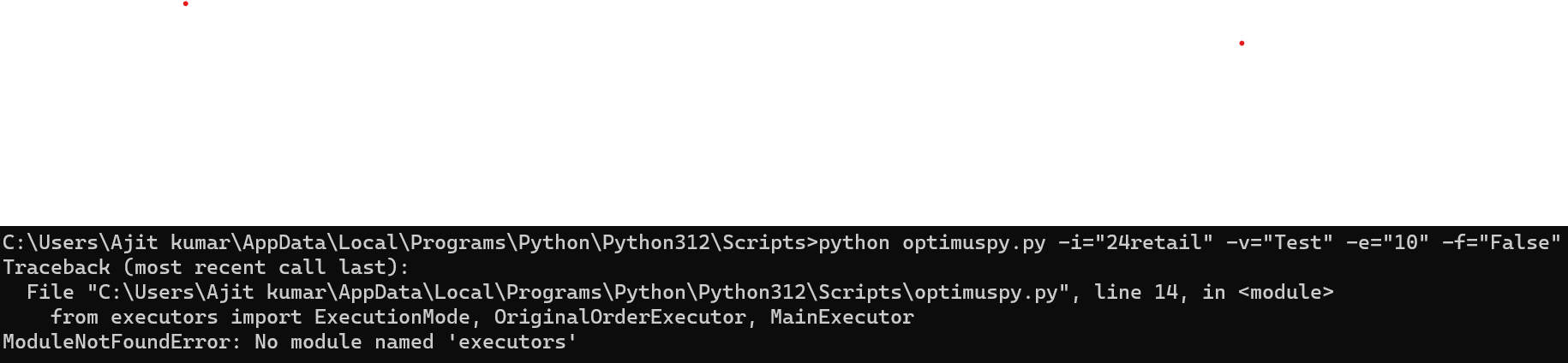

I was trying to use optimuspy as per steps provided on cubewise portal.
https://code.cubewise.com/tm1py-help-co ... -optimuspy
downloaded and installed all the packages as required, but i am getting the the error while running the command on CMD.
error screenshot has been attached.
can you please guide me here what wrong i am doing.
Reply is highly appreciated.
Thanks in advance!

I can't reproduce the error.
Two questions:
- Are you using the latest version of OptimusPy?
- Do you have the same folder structure locally as in the project?
You need to download the folder as it is in the project here: https://github.com/cubewise-code/optimus-py
So the "optimuspy.py" file must be in the same folder as the "executors.py"
I hope this helps.
If the error persists, please raise the issue here: https://github.com/cubewise-code/optimus-py/issues

Hi Marius,
Thanks for your reply.
I believe this is the latest version because i have downloaded from the link (https://github.com/cubewise-code/optimus-py) which was mentioned in the blog of cubewise for optimuspy.
I am referring this link to study for optimus py https://code.cubewise.com/tm1py-help-co ... -optimuspy
Yes, i have created the folder same way as it was instructed like, created TM1py/optimus/all files of optimuspy
i have used the same link https://github.com/cubewise-code/optimus-py to download optimus py.
i am getting some different errors now, will raise it on the link as you suggested.
