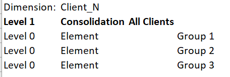

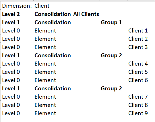

I have 2 cubes with different dimensionality. Both of tchem include „Client” dimension but with another granularity.
In „Cube 1” there is dimension „Client”.
„Cube 2” has „Client_N” dimension.
I would like to copy data from cube 1 to cube 2.
How should be such proccess written? Please help.

So when you define the source you will set the set for the client dimension to be just the Group members as these are the N levels in the destination view.
This means that your view will only contain consolidations.
