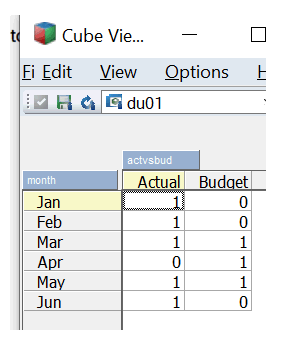

and these filter values, where 1 is a flag indicating the data should be retained.

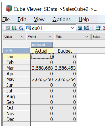

Post VZO we have the result below. From an initially fully populated view we should have data where the cells are 1 in the view above. However we only get the data retained where both cells are flagged.
Post VZO.png (16.31 KiB) Viewed 130943 times
This has been raised and rejected as a defect, since the function is performing as designed even though it clearly does not do what it says on the tin. (TS011806219 / PH52896 )
