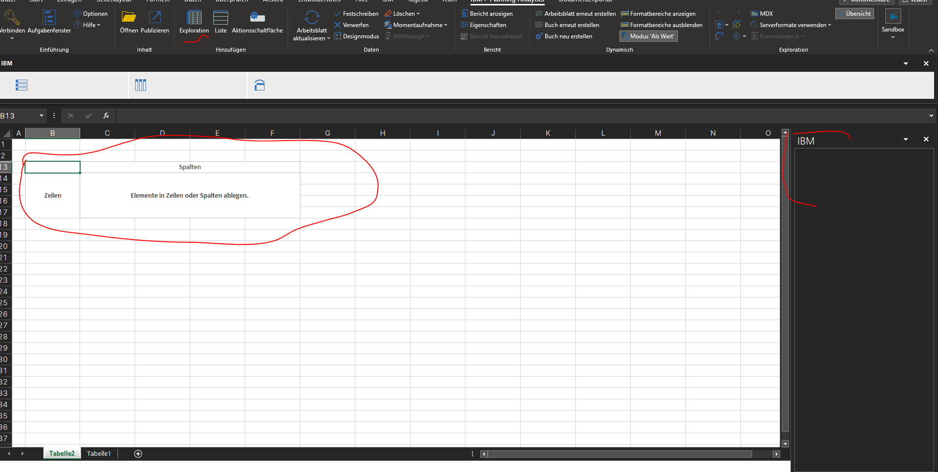

Hello Experts,
we are starting to use Planning Analytics Workspace and also wanted to try out PafE/Pax, but i have an issue and cannot find the answer.
I'm connected to my PA instance over PAW, but the "Sidebar" is still empty, i added an exploration to the sheet but still its empty.
Does someone already faced this issue and know whats wrong here?
Thanks!

I had to set my Excel settings to "Optimise for compatibility" (Datei->Optionen->Allgemein), then everything went well.
