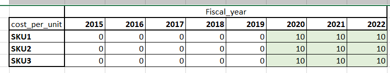

we've had problem with time taking server to start, most time consumed by processing feeders in one cube. Colleague updated most rules in the cube in this fashion:
['item':'cost_per_unit']=>['item':'total_cost'];
['fiscal_year':{'2020','2021','2022'},'item':'cost_per_unit']=>['item':'total_cost'];
and the start-up time got to almost half. Fiscal_year is a dimension with elements 2000 to 2030. But there are data ONLY for 2020,2021,2022, so no more feeders are actually set compared to previous state. I would never expect this, but in retrospect can make sense. Has anyone encountered this? Should all feeders (in large cubes) be written as specifically as possible even though nothing is fed because of 0 values? I'm confused.

My question is why given cube like this (with more dimensions, large cube, just simplest slice for reference)
feeder
should take longer to process than
or as gtonking and MarenC (Thanks!) pointed out, better would be this, to reduce maintenance overhead:
['fiscal_year':'C_planning_years','item':'cost_per_unit']=>['item':'total_cost'];
Why does it take longer given the other years 2015-2019 are empty? Hope this makes sense.
Thanks!
