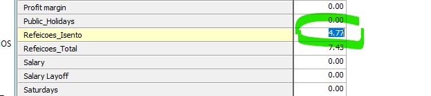

Input is being done manually at a leaf level in a cube as 4.77
When I simply do a DB on a different cube (also at leaf level) I get the 4.7666666669 (around this - almost 15 decimal cases). This remains even if I apply a roundp for 2 decimals. the DB is ignoring this and working with the full number.
I'm already taking the calc away and just concentrating in the DB as it's show the error already like that.
Parameters Cube:
check image attached : parameters_Cube

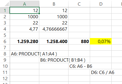

My problem is that they are questioning the difference.
Imagine this scenario : 12 months * 1000 employees * 22 days * 4.77
Now do the same with 4.76666666669 (more or less like the number shown in the picture.
Just like that in this simple example you get near 800 as a difference. As they are comparing with their numbers going away from the excel files they start questioning the numbers.
And precision is true for the visual part but due to the multiplying it doesn't make a difference if you format to 2 decimals or not because you still have the difference.

Hi Jorge,
It's Wim, not Win.
This is the "difference":
I would not lose any sleep over this 0.07%.
I'm certainly not an expert on this.
Could it be the case that some numbers are slightly higher than the original number ? Where the effect would be the inverse and the total net effect almost zero (even less than the above) ?
Also, when the customer is validating, I guess they will use formulas to calculate the rounded percentage difference and anything that is too small will be deemed okay.

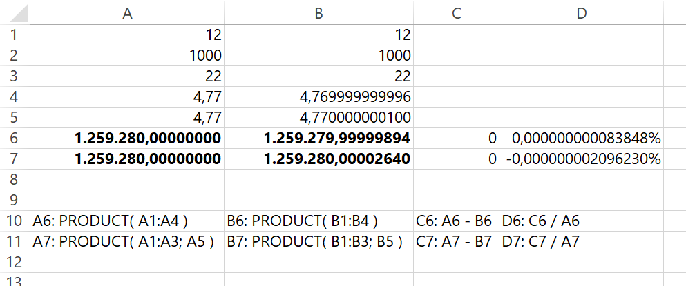

I think at some point you hgave transposed some 9s to 6s.
Originally you say 4.769999999996 (but from the screenshot it is 4.7700000000999996). But then in a later post you quote 4.7666666669. This number can't be correct and if this is the case the difference (althoug as Wim says only 0.07%) is far too large to be due to floating point. There is something else going on, or you just made a typo.
If the real number is either of the first 2 then as stated already this is really a non-issue. It's just how computers store and calculate decimals.

Indeed Lotsa.lotsaram wrote: ↑Tue Aug 02, 2022 2:41 pm Hi Jorge,
In retrospect, I already had a feeling that the deviation was still way too big. Even if only 0.07%. But no time to look at it in detail so thanks for picking up the difference.
Updated figures with 2 situation for the 4.77. The people that have an issue with this, will probably have many many more issues in life
