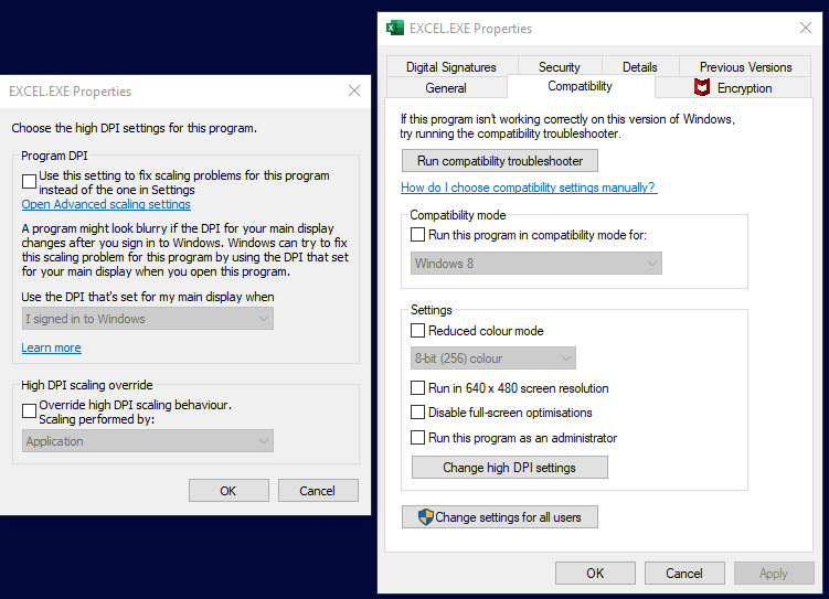

Hi, I think it is a DPI issue but I only have access to Excel Office 365 so unable to test a resolution.
However this screenshot is where I think you may need to make a change to fix the issue...
Find the excel.exe and right click to select properties.
In office 365 this issue is normally resolved by setting the interface to "optimize for compatibility". Stands to reason the issue you're seeing in Excel 2019 is the same, except this excel option isn't available there in standalone versions, excel 2016/2019 etc...

The compatibility tab is missing on the excel.exe on both systems (Win Server 2019 + Office2019 // Win11 + Office365).
It's only a problem in PAX/PAfE. PAW works fine.
