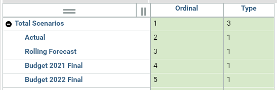

What may be a bit more practical to play with is to return some of these properties as a calculated member using an MDX view on the element attributes cube e.g.
WITH
MEMBER [}ElementAttributes_Scenario].[}ElementAttributes_Scenario].[Ordinal]
  AS [Scenario].CURRENTMEMBER.PROPERTIES("Member_Ordinal")
MEMBER [}ElementAttributes_Scenario].[}ElementAttributes_Scenario].[Type]
  AS [Scenario].CURRENTMEMBER.PROPERTIES("Element_Type"),
SOLVE_ORDER = 1
SELECT {[}ElementAttributes_Scenario].[}ElementAttributes_Scenario].[Ordinal],[}ElementAttributes_Scenario].[}ElementAttributes_Scenario].[Type]} ON 0,
{[Scenario].MEMBERS} ON 1
FROM [}ElementAttributes_Scenario]
BR, George.
