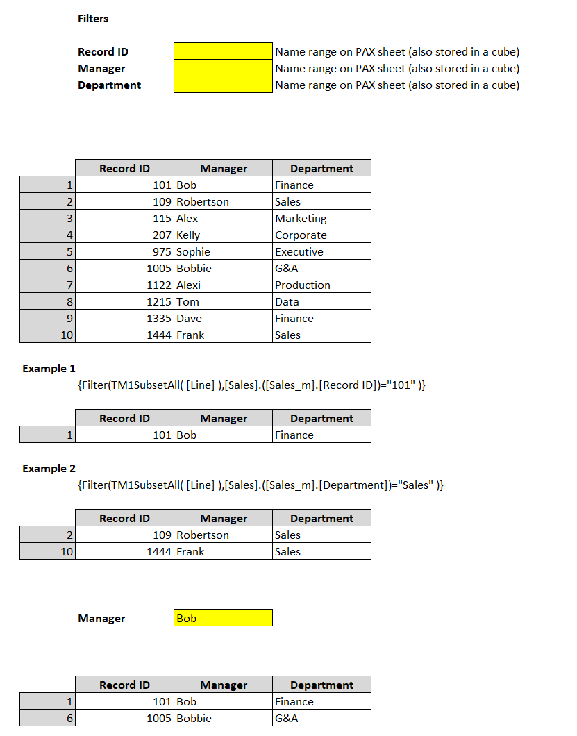

Here are some details:
I have a 2 dimensional cube called Sales which contains a Line dim and Measures.
I want to apply filters to the line dim based on values in the cube.
I'm able to apply filters properly when the value typed into the lookup cell matches exactly or is selected from a picklist, but I'm having trouble when the value typed into the lookup cell should be a wildcard search.
Here's a visual for more details. What I'm trying to achieve is the scenario 3 below.
Any advice would be greatly appreciated!
Line Filters.png (42.67 KiB) Viewed 8830 times
Re: MDX wildcard filter based on cube value
You can use INSTR e.g.:
{ FILTER(
   { TM1SUBSETALL( [Line] ) },
   INSTR([Sales].([Sales_m].[Manager]), "Bob") >0
INSTR documentation: https://docs.microsoft.com/en-us/sql/md ... rver-ver15
