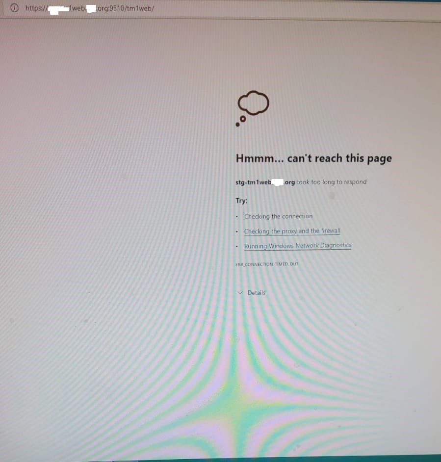

Hi Gurus:
as of last four days, it is working the WEB. but now started not working.
Issue: while login into TM1 Web failed to login.
error: Hmm.... cannot reach this page. server.org took long to respond. Error print screen attached.
I tried checking the fmpsvc_config.xml/tm1web file/IBM Configuration component and compared with Dev and Prod instances and then restarted the services. I think I followed most of the steps posted/available internet but still same issue.
PA local 2.0 version we are using.
really appreciated if any ideas/suggestions to check?
- TM1 Web Error.jpg (105.94 KiB) Viewed 74972 times

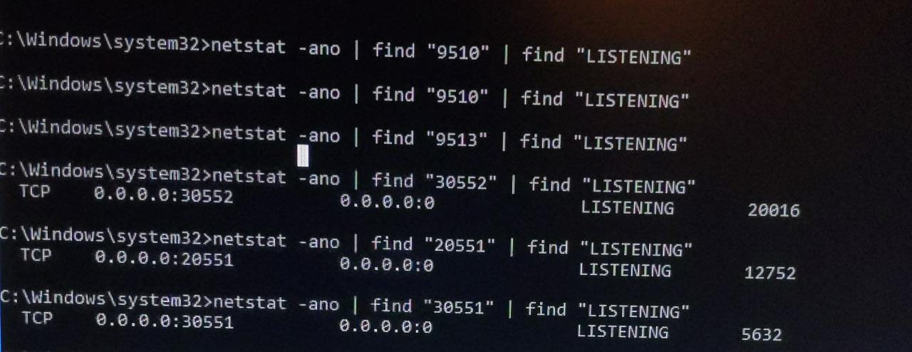

I am guessing port 9510 that we use for TM1web to communicate is blocked can cause this issue? because when I punch the query in command prompt to see whether port is enabled/listening or not. it is not listening where in my other ports that were part of the tm1s.cfg is. pls see print screen, is this cause any guess or help really appreciated. This is actually production issue and tried reaching ibm and there is no help yet.

Re: TM1 Web failed to login
The fact that port is 9510 isn't listening I don't expect to be down to firewall issue, that would normally stop a user from reaching the Web page but wouldn't stop the port from listening.
I suspect the service used for tm1web isn't running/failing to start/crashing (or tm1web has been configured to use a different port, which would have been manually altered). What version of tm1/PA are you on, we need more then just pa 2.0? For example 2.0.8 or 2.0.9.10
Do you have spreadsheet services installed? If so is that service running. If IBM planning analytics spreadsheet service is not installed is IBM cognos tm1 service running?
The fpmsvc_config.xml is only applicable for tm1 applications and the tm1web.config doesn't contain any settings that would effect tm1web to be inaccessible.
You mentioned that tm1web has been restarted, could you confirm what the name of the service was. What was the behaviour when it was being restarted. Did it blanket refuse to start, or did it start but never fully started and where any error messages given.
The event viewer is normally a good place to check for errors of this nature

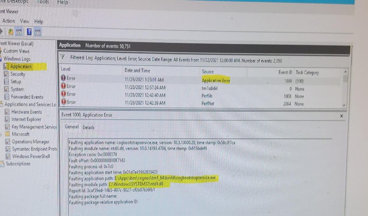

Hi burnstripe,
we have planning analytics 2.0.2 but also i am checking tm1sd.exe file properties, the version 11.1.00000.30.
I can see that in the services as "IBM Cognos PA" is running state that I restarted the "IBM Cognos PA" from "IBM Cognos TM1 Services" from IBM Cognos configuration component. while restarting that I never faced any issues with TM1 web services. I see some application related application logs from the windows logs (Pls see attached print screen).
- WhatsApp Image 2021-11-28 at 10.10.02 PM.jpeg (128.02 KiB) Viewed 74891 times

Is there enough memory free on the service to start tm1web? The memory assigned to tm1web will be set in cognos configuration for your version
Are any disk drives on the server full?
Is there service/named account assigned to the Web service. If so are the credentials correct and not expired/changed
(what's the cognos services doing from the services screen are they in a running state? Starting from cognos configuration won't always show an error so go to services to make sure, judging by that message from event viewer one of them won't be running) when starting from services, take a note of the behaviour, does it terminate immediately, after a few seconds, or after several minutes? Also what's the cpu usage like before the crash?

we have there are five services that are running in this server. PA, adminserver,tm1 servers (3 applications). while I do restart the IBM Cognos PA, I donot see any issues,it is restarted. when i restart the TM1 adminserver one of the application service will go to stopping state therefore I need to goto taskmanager and then kill it and when I went to log directory then I see the tm1s.log holding there so I have to delete it manually. so, considered that, I stopped the service of that TM1 applications and then checking but still same issue. I made it running only one tm1 application to occupy less memory.
we have enough available space of drive 300 gb and then memory is 86% occupied running all three application instances. so I tried up and running only one tm1 application and then it is showing the 26% memory occupied. so I tried with web but still not working. in the IBM Cognos configuration, I can see that 4096 MB specified maximum memory for webshpare. all these tm1 services are running local account and we are able to login into the perspectives and architect we are using the cognos autentication.
one thing I see it that we are using client authentication that I can see it in certificates window that server/common name have renewed the services on 7/12/2021. Is this something I need to update it in the cognos configuration anywhere?

Firstly, I think those two error messages in event viewer arethe result of crashing the application, aka stopping the tm1 application by clicking end task/process,. When you stop the service in such a manor the tm1s.log can become corrupted, out of sync preventing the application from starting until it is deleted. It is advisable to wait for the service to stop itself, rather than forcing it. It could take a while depending if there are locks in progress and a lot of data has changed since the last savedata was executed.
