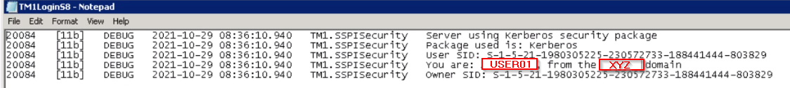

Typically all that is needed is an update on the UNIQUEID to have the relevant domain included there. Sometimes however some users cannot connect and you need to try trace which domain TM1 is actually seeing them originate from.
Up until now this has been impossible, for me at any rate, until I found a logger option for SSPISecurity.
Add TM1.SSPISecurity (Windows - Security Support Provider Interface) as a logger in the TM1S-Log.properties e.g.:
log4j.logger.TM1.SSPISecurity=DEBUG, LOGGER
log4j.appender.LOGGER=org.apache.log4j.SharedMemoryAppender
log4j.appender.LOGGER.MemorySize=5 MB
log4j.appender.LOGGER.File=c:/temp/temp/tm1logger.txt
log4j.appender.LOGGER.MaxFileSize=5 MB
log4j.appender.LOGGER.MaxBackupIndex=5
log4j.appender.LOGGER.Timezone=Local
Results should give you detail about the user's identity:
SSPI Log.png (89.53 KiB) Viewed 103372 times
